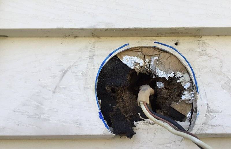

I had a repair guy discover a moist/damp area of exterior wall sheathing behind the vinyl siding of my house. For those not familiar with housing wall layers, you have - starting from the interior to exterior:
drywall (interior - basically this is what you see when you're inside your home) --> insulation and studs (in between the interior drywall and exterior sheathing & siding) --> sheathing ---> exterior home siding (be it brick, wood, vinyl or what have you)
The main posited cause (there could be others, but this is the immediate culprit) is several relatively small nail-sized (the width - NOT the length) holes left behind by a lamp installation contractor a month ago, who did not seal them up (he should have caulked them). Those holes penetrated through the vinyl and through the sheathing entirely, b/c they were nail and screw holes. Over the course of that month (after he left those holes), we've had rain maybe twice a week (some downpours being very heavy and windy).
The wet area of sheathing (that was immediately seen/felt - we did not unfortunately try to look further) was about the size of half a loaf of bread. It's unclear if the insulation behind it was wet or not (it was not checked***). And it's unclear if other areas of sheathing were wet as well. Only the immediate "hole" he opened up where the lamp was installed was seen. That hole size was about the size of a loaf of bread (I have pictures if that helps).
Anyhow, the repair guy said the dampness wasn't too bad and felt it was safe to seal up the vinyl area. I asked if it was really okay (having doubts about whether it could dry in a sealed up environment) and he said he believed so. Note: he was an electrician, so it's unclear if he was qualified to say this.
Pictures would be helpful, at least for me. Are there any openings in the interior drywall through which you could access that space or near to it? Like openings for AC wall outlets, wall switches, vents, etc.? If there are, you might be able to insert some small packets of desiccant into that interior space to help speed the drying process.
Sure, here is one that shows the vinyl siding cut open with the wet sheathing material (the black stuff on left)...it's black on top (maybe paint), but yellow/brown-ish behind it. . .and then "deeper" into that wall cavity you can maybe faintly see some yellow insulation (probably blurry). We dunno if insulation got wet or not, but that sheathing was mushy and damp.
I'm in between calls with lots of ppl still talking just about this subject, so I can post more later, but this was just a quick pic for understanding. As for "openings in the wall," yeah we do have some outlets and a clothes dryer duct, but I'm not super confident about "doing stuff" around those to not damage things if you know what I mean.
That wiring looks suspicious for U.S. standards. Any idea what that Brown wire is for?
From the absence of weather proofing around that hole, I would suggest using a different contractor for the next project. :frown:
Cheers,
Tom
Not an electrician, so dunno about brown wire. Re: weather proofing. IT IS that silver/aluminum foil looking stuff, that degraded I guess over time. You see it on the right side a bit and perhaps the wet sheathing on the left made it slide off? . . .It's not contemporary standard (it was used 30+ years ago in building homes), which has more of a traditional vapor barrier behind vinyl siding. . . .In the old days, I'm told, they used that weird silver-ish looking thin layer.....which does look cheap and like it'd crumble JUST like aluminum foil LOL. :-p
I think that may be old tarnished bare copper ground wire. If so then wiring is not suspect but I'll bet it has been intermittantly wet for some time.
If you put a box there seal around the top and sides but leave the bottom open for a while. This is how it should have been done originally IMHO
That's what I think too.
