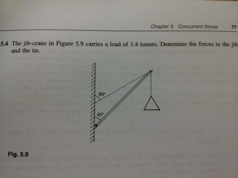

ArronJames
im am a first year mech eng student. I am so lost on this question. the image is the diagram I am trying to solve. i think the compressive stress of the crane boom is what is confusing me. i don't want the answer, just where do i start? Force polygon? math?
please tell me how you would solve this. thankyou
Textbook figure 5.9 of a jib-crane: a vertical wall on the left, a sloped jib from the wall to a hook at the upper right with a tie from the wall to the same point, and a hanging load triangle; angles of 60° and 45° are marked at the wall.
Is this your first year as a freshmen with no statics under your belt? Or have you already taken the core engineering science and Physics courses? If the latter, sum moments about one of the supports = 0. Each member is a 2-force member...the wire in tension and the jib in compression, with their forces directed axially along the axis of the member. Don't forget sum of Fx = 0 and sum of Fy =0.
