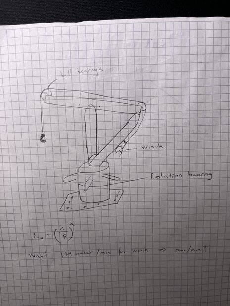

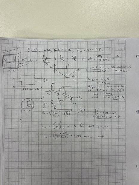

Hey!
I want to determine what bearings to use for this manual crane and the only thing i know is that it should be able to lift a wieght of 1000kg at max and that the winch should pull 1.24 m of cable/min. Im looking to find the force P to then determine C, and i think P is only the radial force so 10kN but i need to show that its true right? So i tried to draw a Free Body Diagram (Its FBD not PBD as in the picture) but im not sure what to do now.

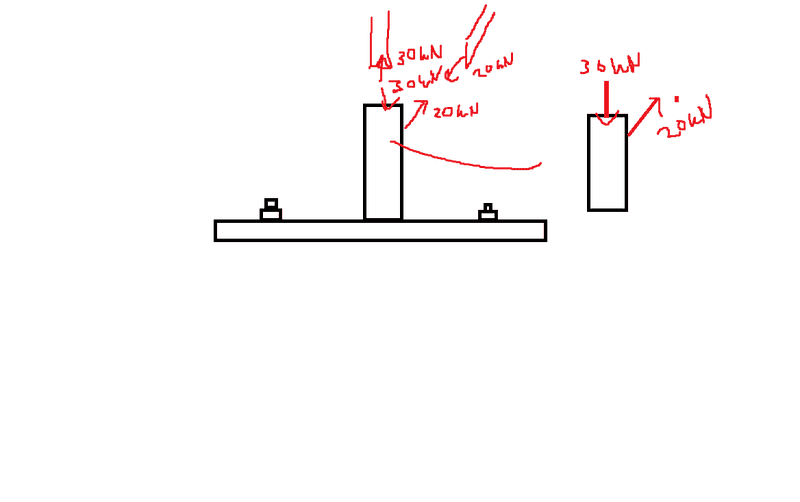

Welcome to PF.
As a rough guide, the base of those lifting arms is usually a thick wall steel tube, about 300 mm long, 100 mm diameter.
It must handle a vertical weight of about 1250 kg, which can be carried on a small diameter bump with grease, in the end of the tube.
The side thrust at top and bottom of the tube is about 450 kg. That side force can be carried on a short polymer sleeve bushing at each end of the tube.
To prevent dirt and water from falling into the bearings, make the female sleeve rotate with the arm, while the male pintle is anchored to the base.

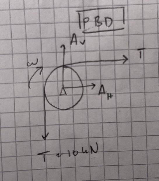

Can you determine the reaction forces ##A_H, A_V##?
If you have a linear velocity ##v = 1.24 ~\rm{\frac{m}{min}}## you relate that to the angular velocity via:
$$v = r_{pulley}~\omega$$

Thanks a lot for your reply.
Thats the thing im not sure how i can determine ##A_H, A_V##. How do i decide the radius for the pulley?
salamikorv said:
Yea i do, is T=A_V? Not sure what to think of A_H.
You have two directions to consider. Because the acceleration of point ##A## is zero, forces are balanced in each direction.
Apply Newtons Law for each direction independently i.e. ##\sum F_x = 0 , \sum F_y = 0 ##.
A_V=T and A_H=-T? Correct?
salamikorv said:
Its A_H=-T?
Ok, so you have the reaction components. Now you need to add them vectorially to find the magnitude of the reaction at ##A##.
Are you talking about the resultant force? So sqrt(A_V^2+A_H^2)?
What can i do with the resultant force here? Wait, is that the force P im looking for?
I think its (approximately) the radial load on the bearing, what do you think?
Ahhh i see, so there's no axial load?
salamikorv said:

But alright until someone explains that lets assume its only the radial force, then that gives me P=sqrt((1000*9,82)^2+(1000*9,82)^2)=13,888kN. And lets say i want almost infinite life so L10=10^4 revolutions and a=3 for ball bearings, so that gives me the dynamic load capacity to be C=299 kN which is pretty high, have i done something wrong?
salamikorv said:
But alright until someone explains that lets assume its only the radial force, then that gives me P=14,142kN. And lets say i want infinite life so L10=10^6 revolutions and a=3 for ball bearings, so that gives me the dynamic load capacity to be C=1414213 N which isnt even in the SKF catalouge, what have i done wrong?

Time for me to wake up.
I was summarising with regard to the rotation bearing at the base.
The winch wire passes over pulleys, the minimum radius of the pulley is determined by the winch wire details.
The radial force applied to the bearing of a guide-pulley could be from zero to twice the wire tension, depending on the change in wire direction over that pulley; Sin(2Θ).
There is little axial force on the guide pulley support bearings.
The winch drum is another issue, with alignment problems.
We need a better diagram of the machine, with identification labels on components. We need a specific question about one part of the mechanism.

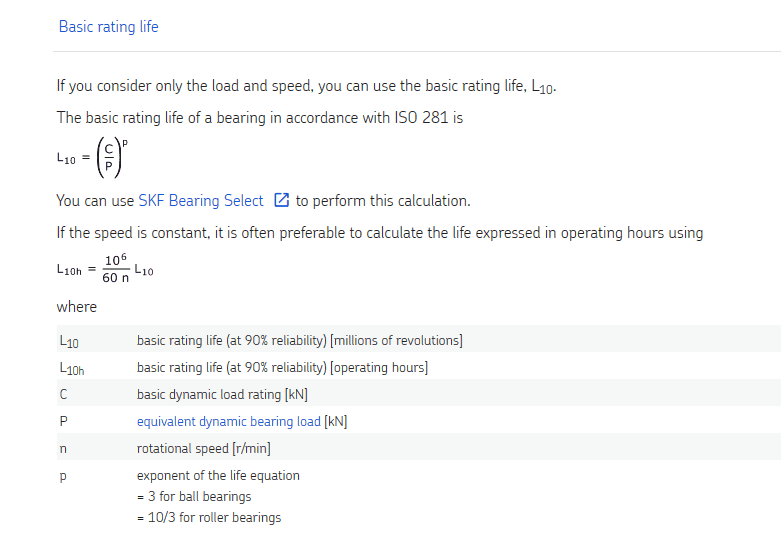

As far as I can tell from the SKF website:
Bearing Rating Life
Notice the units on ##L_{10}##?
Bearing Rating LifeView attachment 324876

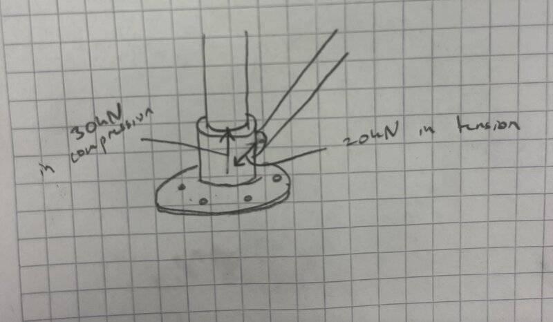

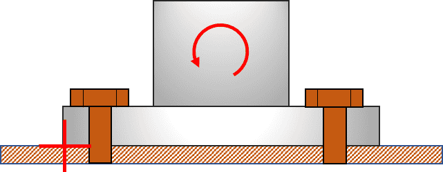

Sorry for the late reply. Yea ive been using these formulas quite a lot now, thanks. How would i do with the bolts at the bottom? I want to choose what bolts to use for the bottomplate, here:d

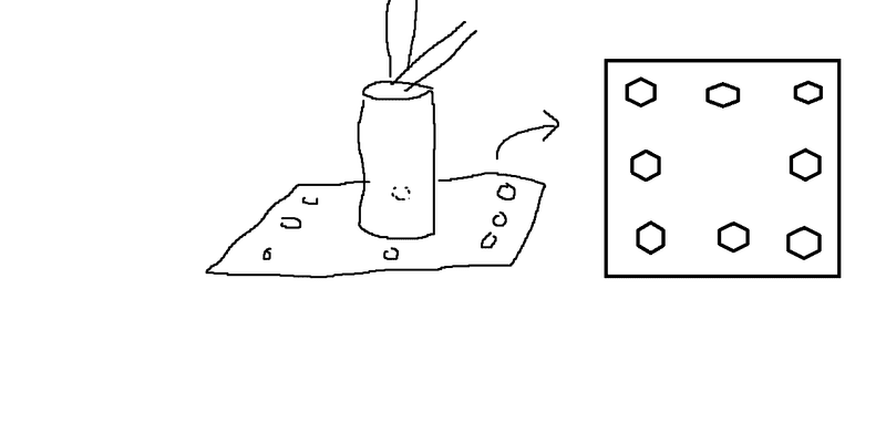

Each bolts is evenly spaced out, i couldnt draw it so good but i think you get the point. I need a force thats acting on that plane right, but what force? I only know the force from the lift which is directed "into" the plane/bottomplate.
Will the baseplate fail by bending?
How thick is the steel baseplate?
How is the vertical mast-tube attached to the baseplate?
What foundation is the baseplate bolted to?
Bolt tension is determined by mode of baseplate failure and:
1. Hook radius from axis.
2. Baseplate bolt Pitch Circle Diameter.
3. Number of bolts.
3. Number of bolts.

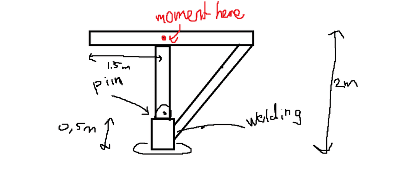

1. Im not sure.
2. I think ill use 30mm in thickness.
3. Through welding.
4. I was thinking to the floor.
5. The hook radius would be 1.4 meters.
6. Is that the length of each side of the baseplate? 0,5 meters.
7. 8 bolts i think would be enough, placed like in the picture.

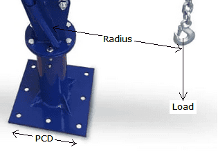

I think that will be more than sufficient. I would guess closer to 12 mm.
But I would use diagonal gussets to stiffen the plate, like shown in my picture.
No. The 4 closer of those bolts lie on that diameter of a circle.
Assume only two bolts carry all the tension. n = 2.
Bolt tension = load * radius / ( n * PCD ).
Ohh thats PCD, alright then maybe 0.3. How can i use the bolt tension to determine what bolts to use, and is the load in the formula 1000*9.81?
Another thing, this is for the bearing, i got these calculations and i ended up with 0,7 revolutions....
And the text part is saying "choosing a ball bearing diameter of 35mm from SKF, bearing 16003 with C = 6,37kN" What should i do to fix this and get atleast a million revolutions or higher.
PCD = Pitch Circle Diameter.
Load =1000 * 9.81 newton.
Look at manufacturer's bolt specifications.
You need to consider how the bolts are held in the floor, so they do not pull out.
