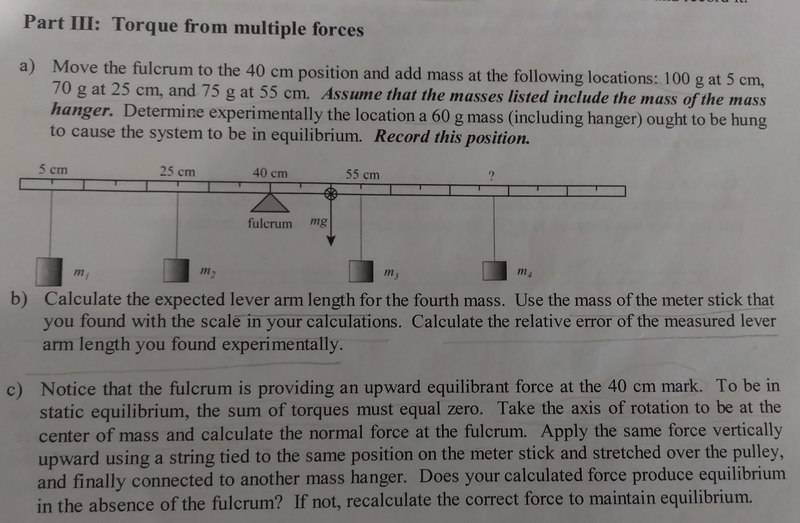

I did torque and equilibrium lab report, where I had to hang some weights on a meter stick, which was placed on a fulcrum. There were 3 parts for the lab, with different settings. I am stuck at the last part, where I hang the meter stick with a string over a pulley, and there were 4 weights hanging on the meter stick with a string for each at different displacement.
Like this:
At last, book says,
Lab handout diagram of a meter stick on a fulcrum at 40 cm with four hanging masses at 5 cm, 25 cm, 55 cm and an unlabeled position, plus the 'Part III: Torque from multiple forces' instructions.
How do I calculate the normal force?
I have also attached my excel sheet for the review too.

They ask for the normal force at the fulcrum, which is just the total weight of the stick and weights, no?

You obtained it by adding the masses and multiplying by g, which is equivalent to multiplying each mass by g then adding the resulting weights. Therefore what you have found is the total force due to gravity on the stick+masses system. What other force(s) act on that system?

The normal force is what holds the setup up, and keeps it from falling. That is either supplied by the fulcrum pushing up on the stick, or in the later configuration it is supplied by the rope pulling up at the same point on the stick as the fulcrum was pushing up before.
When I stand on the floor, the normal force pushes up on my feet to keep me at that height. If there were no floor pushing up on me, I would fall in the downward direction.
Does that help?

The force of gravity acts to pull the system down. What force stops it moving down?
Oh!
That mean's a normal force of 4.30 N which is acting in the upward direction stops the meter stick, which is carrying masses, from falling downward. Am I right?
