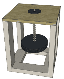

i have a question. I have set up an expierment and need some values.
I have a round, 3d printed disk, 0.25 inches thick and 4 inches in diameter. In the center, i have a eye-bolt attached. I have hooked up a chain to the eyebolt and some weight to the chain.
I have 40Lbs hanging right now and no issues.
here is what i what to calculate. If i lift the 40 lbs of weight 10 inches from rest, and then drop it, i want to calculate the amount of force it puts on the 3d printed part. assume the chain or nylon cord is negligible for absorbing energy. Resting weight is much easeir to deal with than if i just drop the mass.
not sure if just hte basic F=ma will do the trick or if this is more along the line of momentum and using F=mv/t would be best or if there is even a better way. Im not looking for KE, i would like the amount of force as the mass hits the end of the chain and "tugs" on the eyebolt
thanks

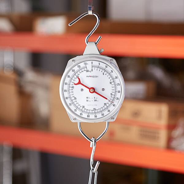

I agree with @kuruman that making some measurements would be helpful. A first cut would be to use a simple fish spring scale to see what the weight-versus-time looks like. You can probably buy a fairly inexpensive ($32) 100lb scale at Amazon or similar:
https://www.webstaurantstore.com/av...aMKbVaaTf3dE8vN6lGiMY1KUe_6i0R4xoCvLwQAvD_BwE
The spring mechanism will provide some shock absorption, though, so the numbers you see will be slightly less than the real peak force (weight). To get a better idea of the peak force, you would want to use a friction/deformation gauge that does not apply much damping: (I could not find any good links for this, sorry).

As for the strain gauge or scale, i like that idea. It gives some real numbers to work with. I am looking for some basic calculations as well so i can add those to a report im writing.
ALl i am going to do is lift the weight with my hands, and then drop them. thats all i want to calculate. I guess if i know the fall time (answers my question above), i can get a basic number.

this is my test bench i made to test hanging weight until failure and now i want to test snatch force or drop force or whatever it is really called. my goal is to find out at what force the eye bolt pulls through the plastic or the part fails by dropping the weight.
