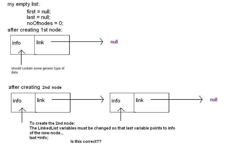

I'm trying to understand a generic linked list...in Java.
I understand that I should have a LinkedList class containing a Node class.
The Node class should have an info variable and a link variable.These variables should be accesessed through the .dot operator.
Now my book has a huge chapter on it,but unfortunately introducing generics and Linked Lists with a million different interfaces isn't much use to a noob.
My biggest problem seems to be in understanding how a node is inserted into the list.
For example the book shows a Node constructor having the following parameters:
(T elem,LinkedList<T> ptr)...I understand that T can be anything except primitive type parameters.But what I don't understand is in what context will this method be used??
Most likely we will be required to squash an array of Integer or String values into a linked list...So assuming that I have this : Integer[] anArray={1},{2},{3},{4}
How would I go about constructing nodes with these values...The constructor has a parameter,LinkedList<T> ptr.Where am I intended to get this reference variable from.
  • Hand-drawn diagram of a linked list: an empty list with first, last and noOfnodes set to null and 0, then one node with info and link fields pointing to null, then two nodes linked, with a note asking whether last = info is correct.
I don't know a thing about Java because I prefer C++'s transparency so I'll just say that your assessment of a linked list is accurate. When you implement a linked list, it's important to create a "root" pointer that points to the first element of your list, then use a temp variable to create subsequent nodes by repeated use of the "new" command.
