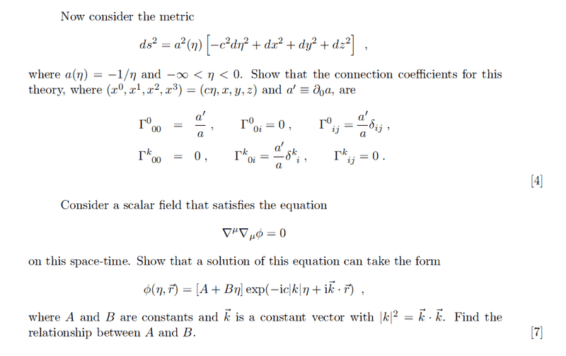

(a) Find the christoffel symbols (Done).
(b) Show that ##\phi## is a solution and find the relation between A and B.[/B]
Handwritten-style typeset page showing the metric ds² = a²(η)[−c²dη² + dx² + dy² + dz²] with a(η) = −1/η, the Christoffel symbol results, the scalar field equation ∇^μ∇_μ φ = 0, and the proposed solution φ(η, r) = [A + Bη] exp(−ic|k|η + ik·r).
Part(b)
[tex]\nabla_\mu \nabla^\mu \phi = 0[/tex]
I suppose for a scalar field, this is simply the normal derivative:
[tex]\frac{\partial^2 \phi}{\partial \eta^2} + \frac{\partial^2 \phi}{\partial r^2} = 0[/tex]
Starting with the ##\eta## component:
[tex]\frac{\partial \phi}{\partial \eta} = exp() \left[ B + (A+B\eta)(-ic|k|) \right][/tex]
[tex]\frac{\partial^2 \phi}{\partial \eta^2} = exp() \left[ -2ic|k|B - |k|^2c^2(A+B\eta) \right][/tex]
Now for the ##r## component:
[tex]\frac{\partial \phi}{\partial r} = exp() \left[ A+B\eta \right](\vec k \cdot \hat r)[/tex]
[tex]\frac{\partial^2 \phi}{\partial r^2} = exp() \left[ -(A+B\eta)(\vec k \cdot \hat r)^2 \right][/tex]
Equating both real parts doesn't work; It gives ##(\vec k \cdot \hat r)^2 = |k|^2 c^2##..
What is ##\nabla_\mu## here? I would have thought they'd be covariant derivatives, not partial derivatives. (?)
Even though a covariant derivative of a scalar field is just the partial derivative, the 2nd covariant derivative is acting on a vector...
strangerep is correct, the second covariant derivative is not acting on a scalar, but on a covariant vector. I suggest rewriting it as
\nabla^\mu \nabla_\mu \phi = g^{\mu\nu} \nabla_\mu \nabla_\nu \phi
and apply the rules for covariant derivatives from there.

I know that for a vector field, ##\nabla_\alpha V^\mu = \partial_\alpha V^\mu + \Gamma^\mu_{\alpha \gamma} V^\gamma##. Does this apply to scalar fields as well? Or in the case of a scalar field, does it simply reduce to a normal derivative?
I have also found that
[tex]\nabla_\alpha \nabla_\beta V^\mu = \partial_\alpha \partial_\beta V^\mu + \left(\partial_\alpha \Gamma^\mu_{\beta \nu} \right)V^\nu + \Gamma^\mu_{\beta \nu} \left( \partial_\alpha V^\nu \right) + \Gamma^\mu_{\alpha \nu} \left[ \partial_\beta V^\nu + \Gamma^\nu_{\beta \epsilon} V^\epsilon \right] + \Gamma^\nu_{\alpha \beta} \left[ \partial_\nu V^mu + \Gamma^\mu_{\nu \epsilon} V^\epsilon \right][/tex]
No, for scalar fields you have ##\nabla_\mu \phi = \partial_\mu \phi##. However, ##\nabla_\mu \phi## is a covector field and as such its covariant derivative ##\nabla_\nu\nabla_\mu \phi## will involve a Christoffel symbol.
