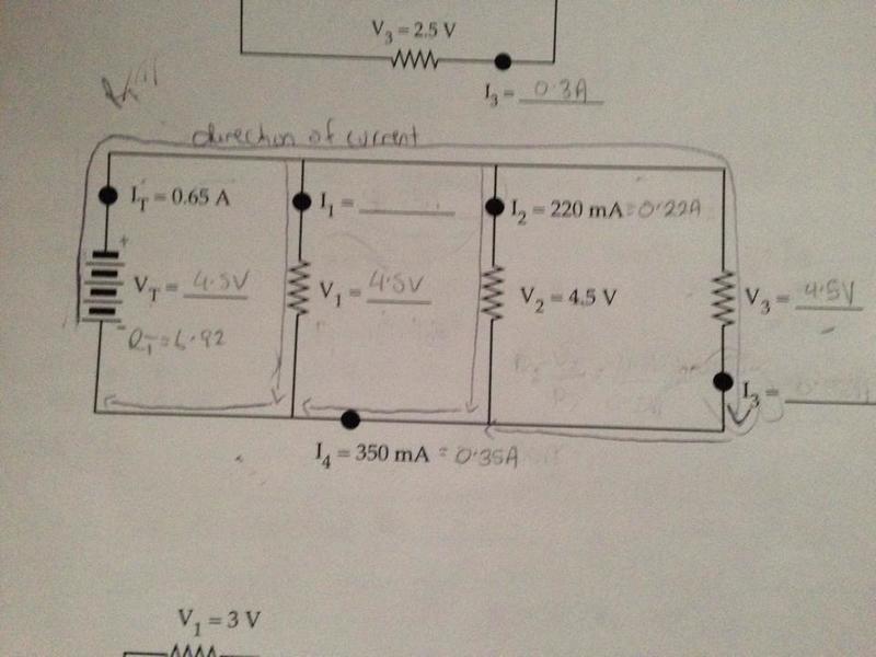

i did the question but I am not sure if they are right. i wrote my answers on the attachment
  • Hand-annotated circuit schematic with a battery and four parallel resistor branches, labelled I_T = 0.65 A, V_T = 4.5 V, I_2 = 220 mA = 0.22 A, I_4 = 350 mA = 0.35 A, V_1 = V_2 = V_3 = 4.5 V, and I_3 = 0.3 A on a separate branch above; handwritten current direction arrows are drawn along the wires.

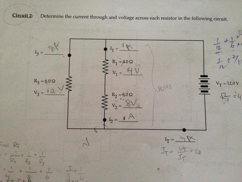

and can someone please explain how to find the Current if only the resistance and total voltage is given? and I am confused on how to identify when some thing is a series or parallel when both are in a circuit together like this?
  • Handwritten solution to Circuit 2 showing a circuit with R1 = 4.0 Ω and V1 = 4 V in series with R2 = 8.0 Ω and V2 = 8 V, R3 = 6.0 Ω and V3 = 12 V in parallel, and total voltage VT = 12.0 V; the current values are partly filled in.
Well the answer here is you have both :) R1 and R2 are in SERIES with one another and they are then in PARALLEL with R3.
Have you learned how to do voltage dividers and current dividers?
A method to solve simple problems like this is to simplify first then solve.
1) take the series resistors and make them into one (eg R4 = R1+R2)
2) take the parallel resistors and make them into one (eg 1/R5 = 1/R4 + 1/R3)
now you are left with a voltage source and a resistor. You can figure out I from I=V/R
Next you have to do the fun part.
Use a current divider equation to figure out the current through R4 and R3
Then use a Voltage divider to figure out the voltage drop across R1 and R2.
