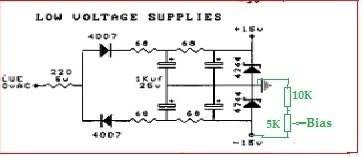

Hi guys,
I was given this Mesa Boogie Nomad 45 chassis. I repaired it yesterday and have it working more or less well.
Mesa does not install adjustable bias in any of their amps. I want to install a trimmer pot to control the bias.
Where in the circuit should I place the trimmer resistor and what do you think the value of the trimmer resistor should be?
http://schematicheaven.net/boogieamps/boogie_nomad45.pdfCheers,
Billy

The obvious place to insert a trimmer would be at the bottom of the grid resistor, but I do not think that you have access to a negative voltage. There are other ways, but most of them involve a thorough understanding of valve amplifiers - and that understanding is scarce nowadays.
Hi Svein,
The schematic is kinda of a mess but if you page down to page 7 you will see the power amp section and the 4 El84 power tubes. All the way down at the last page called page 2 you will find the power supply schematic which contains a -15v dc supply.
The grids are currently bias per the schematic at -12vdc and actually measuring -11.5Vdc. Very small changes in the negative voltage results in large changes in plate current. Point being I want to be able to change that negative voltage up or down as needed within the limits of the negative supply voltage that exist.

I think i'd add a few hundred ohms of cathode resistor to each tube, bypassed with a big electrolytic capacitor of course
and make a master bias control so
that'd give you 5volt adjustable bias, only adding a milliamp to power supply load
rheostats in the cathodes would make the tubes individually adjustable
Size for maybe 5 volts at nominal cathode current ?
maybe a half the R adjustable and half fixed ?
Just bypass them so as to keep gain same.
A voltmeter mounted on panel with a switch to read across each tube's fixed part of Rcathode would let ypu balance them.
have fun !
old jim

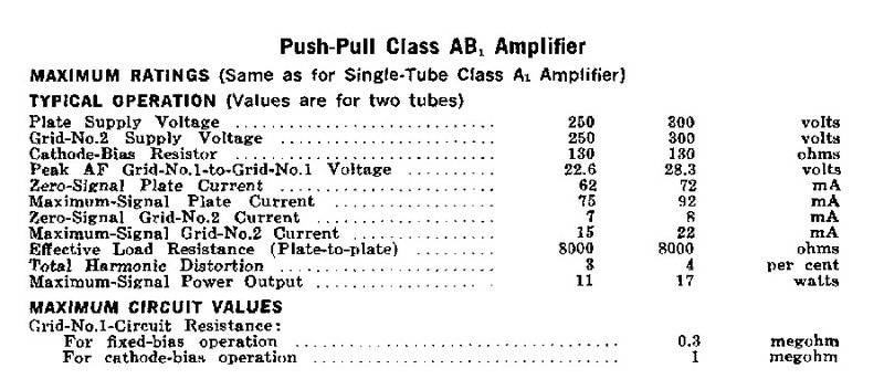

This is a general chart that is widely used and 70% of the total value being a safe and sort of normal value. These values shown on the chart agree pretty close to the MFG data sheets I have seen. There are current MFG's that are producing 6l6's that indicate 30W dissipation for example but all the MFG data sheets for EL84's indicate 12W
So 12W/400V X .7= 21 ma If the valves in this amp were running at max data sheet stated voltage of 300V then the 70% value would be about 28 ma.
I have always assumed that the wattage given in the chart indicated max signal power output. So perhaps I really don't understand what max signal power means. The 4.8W dissipation from the heater just escapes as heat correct?

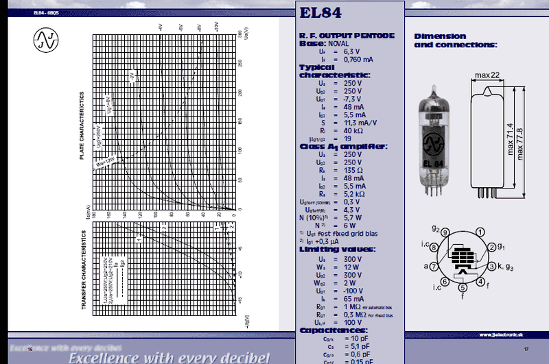

Here is the JJ EL84 data sheet I am basing my info off...sorry I don't know how to cut and paste a PDF. http://www.drtube.com/datasheets/el84-jj2003.pdf
So perhaps you could explain why you consider 35ma to be "not to bad" in the context of the EL84 running at 400V.
I am a bit confused...as usual..lol
Cheers'
Billy
Plain and simple: 15 years of working with EL84 and similar valves. And - as I said - you are essentially running a class A (or possibly AB) amplifier (http://sound.westhost.com/class-a.htm), which means that you will have a relatively large no-signal current.
That datasheet snip in post 8 is from the RCA tube manual at the link you posted. I copied the pdf into my 'electronics' folder, all700 pages...
Observe it says~60 to~70 ma for idle current. (did i snip right page?)

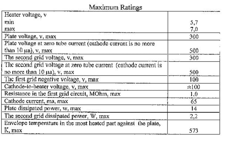

Hi Jim,
Yes, the one you posted matches my RCA book. If I understand what I am reading Maximum Signal Power goes up as plate voltage increases per the RCA book...11W at 250V and 17W at 300V so 400V...?.This is the JJ data sheet for the tubes I have in the amp at the moment..
This one below is from a Russian Data Sheet...the first one I have seen that gave a max value for max temp. 573K which =571.73F...WOW! that's HOT..but Borosilicate glass has a melting point around 820oC (1,508oF) so I guess that could be correct.

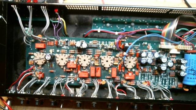

Hi Guys,
Jim an I have done a bit of troubleshooting on this amp. So perhaps I should bring everyone up to date.
Disregard the original questions about bias and bias issues. All the tubes are running at normal voltages and all three channels are working more or less. I now have a foot switch and it is working normal.
This is what is not working.
The reverb unit is not working. There is no negative voltage at the op-amp which is a NE5532 and no negative voltage at the two Zener diodes for the low voltage supply.
The record out/headphone circuit is not working.
Channel two master volume control is not working and when I switch to channel two the channel three master volume is controlling channel two. My guess is that is a relay issue. Also the channel three LED is always on which I assume is not normal.
I have ordered several parts from Digi-Key which will be here on Wednesday to include new relays so some things can not be done until then.
My question for today is can I disconnect the record out circuit all together for the moment and can I disconnect the reverb circuit. I need to be sure that whatever is causing the negative supply to fail can be isolated .
I ASSUME that removing the .047 cap in the record circuit would disconnect the circuit without issue. YES...NO...Better idea?
As for disconnecting the reverb circuit I am not sure?
As you can see there is a ton of stuff crammed into this amp. Also there are traces on both sides of the PCB and very little information on the PCB that relates to the schematic. This is one of the most complex guitar amps I have tried to work on.

Update
I have the low voltage supply working now.
I fixed the record out circuit by replacing the op-amp with a new original TI NE5532
-15V and +15V to the both op-amps now.
Reverb still not working. I need to replace the general purpose NE 5532 op-amp I put in with the new Texas Inst. original I now have. I am not sure if that will help but at least I have the correct voltages going to the op-amp now. I may do some signal tracing before I change it.
