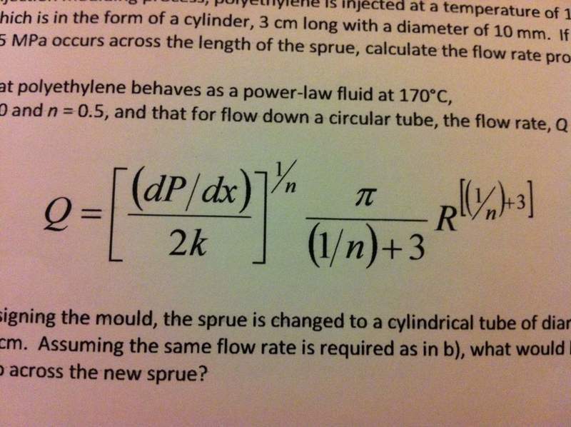

mstephens88
[a]1. How do I make dp the subject?
Q=[(dp/dx)/2k]^(1/n).[pi/(1/n)+3].R^(1/n)+3
^= power of
Please Help
I also have attached the equation.
Thanks
M.Stephens

The equation is for flow rate down a circular tube, in my question i am asked to rearrange the equation to find the pressue drop(dp).
I have attached a picture of the equation.
Thanks

You can leave [itex]\left(\frac{dP/dx}{2 k}\right)^{1/n}[/itex] on the r.h.s. and move everything else on the l.h.s.:
[tex] \frac{\left(3 + \frac{1}{n}\right)}{\pi} \, Q \, R^{-3 - \frac{1}{n}} = \left[\frac{dP/dx}{2 k}\right]^{\frac{1}{n}}[/tex]
What would be the next step?

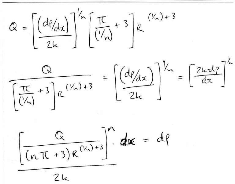

Does the equation in the attachment look correct?

mstephens88 said:
sorry Dickfore but that doesn't make n e sense to me?
In post #8, Dickfore multiplied both sides of the equation by the reciprocal of what was multiplying [(dP/dx)/(2k)]^(1/n).

I think it should be done simpler in this case. Replace the infinitesimal change with a finite change ([itex]\alpha\equiv n^{-1}[/itex]):
[tex]Q=\left(\frac{\Delta P}{2k\Delta x}\right)^\alpha\frac{\pi R^{\alpha+3}}{\alpha+3}[/tex]
[tex]\Rightarrow\Delta P=2k\Delta x\left(\frac{(\alpha+3)Q}{\pi R^{\alpha+3}}\right)^{1/\alpha}[/tex]
Filling in all numerical values should give you the pressure drop.
Ok yes think I've got the correct answer, i do apologise it was the derivative of pressure. thank you all for your help.
MS
