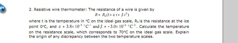

Textbook problem 2 on resistive wire thermometers: resistance equation R = R0(1 + alpha t + beta t^2) with alpha = 3.8x10^-3 per degree C and beta = -3.0x10^-6 per degree C squared, asking for the resistance-scale temperature equal to 70 degrees C on the ideal gas scale.
[itex]\Delta R[/itex]/ R0 = [itex]\alpha[/itex] [itex]\Delta T[/itex]
which goes down to : r-r0 /r0 = alpha (T-T0)
r/r0 = alpha T +1
3. The attempt at the solution
Hi there, I'm on a verge of mental breakdown. I have spent over 2 a4- sheets on figuring out how to get 't'.
I have found out the value r/ro... however the part to find 't' has been daunting... I am aware of the expression within the bracket being a quadratic equation,hence two solutions of 't'... but what becomes of the value of r/r0 ?
Thanks for your help in advance.
Although I have sent my work to be marked but can anyone tell me how I should have proceeded with this question ? Thanks
