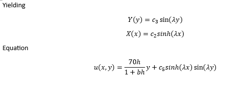

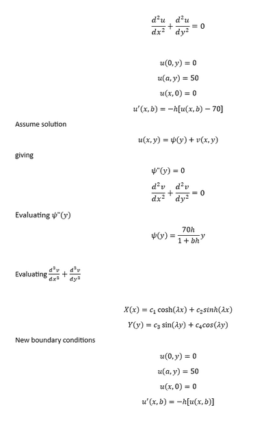

I've tried a few things. I did one method to try to accomplish the removal of the -70 in the derivative boundary condition. It came out as below. When plotting it however it gave a solution that didn't make sense.
Handwritten derivation of a Laplace equation problem: d2u/dx2 + d2u/dy2 = 0, boundary conditions u(0,y)=0, u(a,y)=50, u(x,0)=0, u'(x,b) = -h[u(x,b)-70], then substitution u = psi(y) + v(x,y), psi(y) = 70h y/(1+bh), and separated forms X(x) and Y(y) with new boundary conditions.
Handwritten separation of variables solution: Y(y) = c3 sin(λy), X(x) = c2 sinh(λx), and u(x, y) = 70h/(1 + bh) y + c5 sinh(λx) sin(λy).

The conditions are actually
Four boundary conditions: u(0, y) = 0, u(a, y) = 50, u(x, 0) = 0, and u'(x, b) = -h[u(x, b) - 70].
I'll fix it also on the original post.
It's what you have but y instead of x.
Equation: 50 = (70h)/(1 + bh) y + c5 sinh(λa) sin(λy)

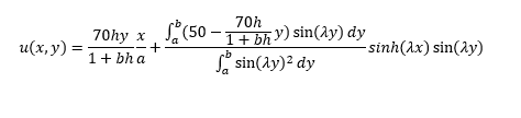

Displayed equation for u(x, y): 70hy/(1 + bh) + [integral from a to b of (50 - 70h/(1 + bh) y) sin(λy) dy] / [sinh(λa) times integral from a to b of sin(λy)^2 dy] times sinh(λx) sin(λy).
The problem is, this gives an answer where for all y when u(0,y)=0 when x should be zero, x does not equal zero.
The funny thing is if I manipulate the equation by multiplying the first term by x/a. I can plot a solution that makes sense.

  • Equation: 50 = (70h / (1 + bh)) y + c5 sinh(lambda x) sin(lambda y), with lambda written as λ.

  • Typeset equation for u(x, y) = 70h/(1 + bh) y + [integral from a to b of (50 - 70h/(1 + bh) y) sin(λy) dy] / [integral from a to b of sin(λy)^2 dy] times sinh(λx) sin(λy).

  • Solution formula u(x, y) = 70hy x/(1 + bh a) + [integral from a to b of (50 - 70h/(1 + bh) y) sin(λy) dy] / [integral from a to b of sin(λy)^2 dy] times sinh(λx) sin(λy).
You're only satisfying the boundary condition at [itex]x = a[/itex]. No wonder you don't get the right value at [itex]x = 0[/itex].
Setting [itex]u(x,y) = \frac{70hy}{1 + bh} + v(x,y)[/itex] gives [tex]\begin{split} v(0,y) &= -\frac{70h}{1 + bh}y \\<br /> v(a,y) &= 50 - \frac{70h}{1 + bh}y \\<br /> v(x,0) &= 0 \\<br /> \left.\frac{\partial v}{\partial y}\right|_{(x,b)} + hv(x,b) &= 0. \end{split}[/tex] This gives you [tex] u(x,y) = \frac{70h}{1 + bh}y + \sum_{n=1}^\infty X_n(x) \sin k_n y.[/tex] Now [itex]X_n[/itex] is a linear combination of [itex]\cosh k_n x[/itex] and [itex]\sinh k_n x[/itex]. But instead of taking [itex]X_n(0) = 0[/itex], you must take [tex]\sum_{n=1}^\infty X_n(0) \sin k_n y + \frac{70h}{1 + bh}y = 0.[/tex] You can't just ignore the [itex]\cosh k_n x[/itex] solution, you need it to satisfy this condition.
It is, however, more convenient to take advantage of the fact that [tex]\sinh k_n(a- x) \equiv \sinh k_n a \cosh k_n x - \cosh k_n a \sinh k_n x[/tex] is a linear combination of [itex]\cosh k_n x[/itex] and [itex]\sinh k_n x[/itex] and set [tex] X_n(x) = \frac{A_n \sinh k_n(a-x) + B_n \sinh k_n x}{\sinh k_n a}[/tex] so that [tex]\begin{split}<br /> 0 &= u(0,y) = \frac{70h}{1 + bh}y + \sum_{n=1}^\infty A_n \sin k_n y \\<br /> 50 &= u(a,y) = \frac{70h}{1 + bh}y + \sum_{n=1}^\infty B_n \sin k_n y \end{split}[/tex]
