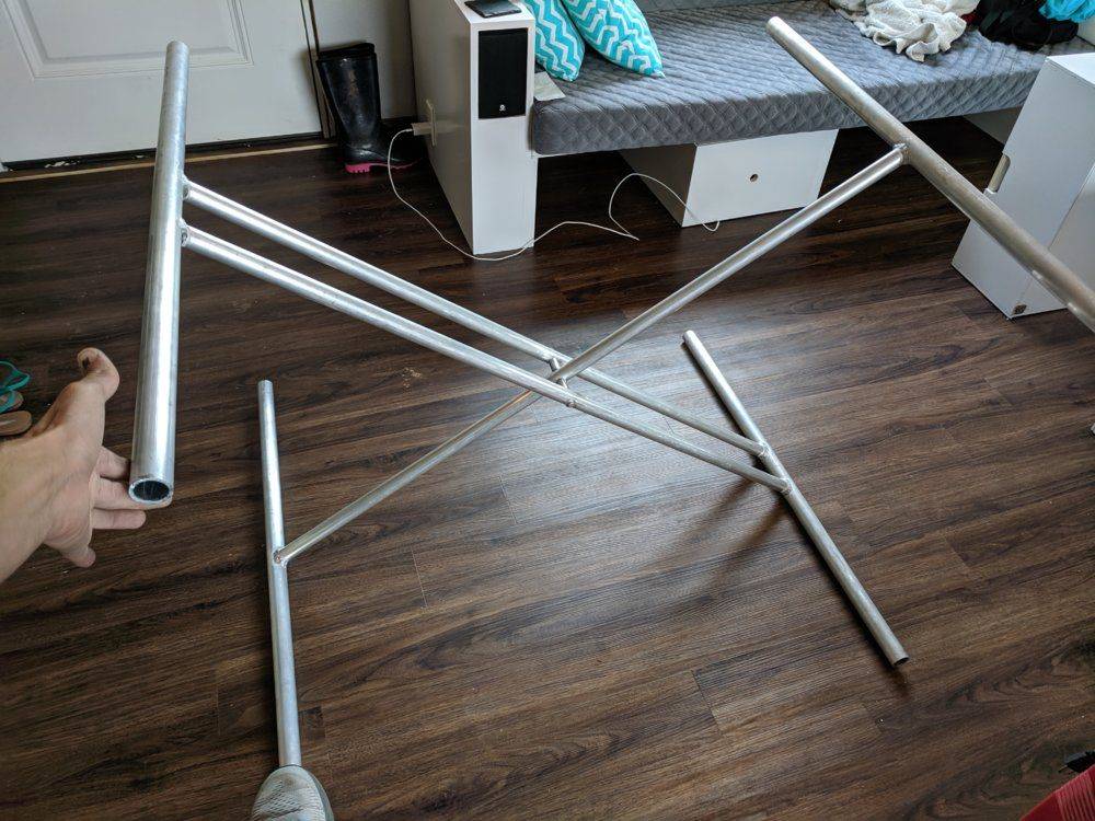

Animag771
TL;DR
My DIY ironing board-like table is springy and wobbles when touched. Is there any way to stiffen the pipe to beef it up enough to keep it from flexing?
So here's what's going on... I've gone and made an attempt at building a height adjustable table.
244076
244077
Originally I was going to use stainless steel for the pipe, but after finding out that it would more than quadruple the price, I ended up with SCH40 Aluminum. I used three 48" long, 1" ID pipe for the legs which criss-cross and attached them to two 36" long, 1.25" ID feet.

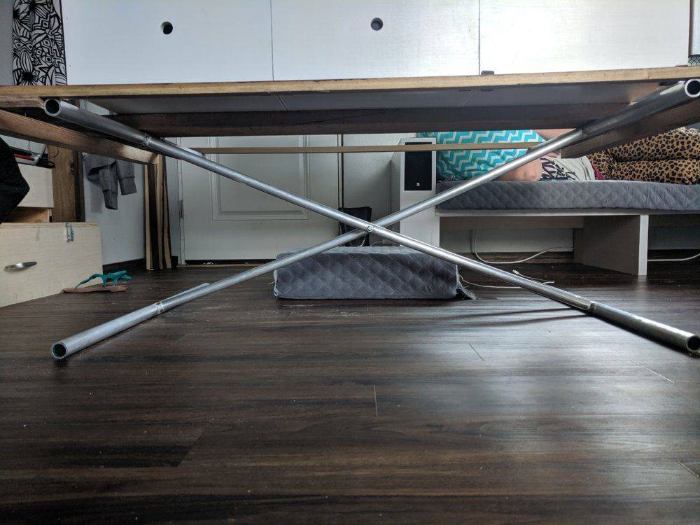

I put it all together and mocked up a table top and everything works great... Then I added some weight to it do simulate the weight of the actual top I plan to use (70lbs) and the pipes start to flex and it makes the whole thing kind of springy. If you set a glass of water on top you can see the water moving back and forth as the table bounces (jiggles?) until it finally settles and stops.
Is there any way to stiffen this thing up enough to make it more solid? I thought about drilling into the long pipes and filling them with concrete, but what happens when that starts to crack? I also thought of cutting the welds and inserting 1" solid steel rod (or flat steel oriented vertically) into the pipes. Or there's always the option to add pipe.
Would any of these options work? Any other ideas? Or am I out $100 and need to redo this with larger diameter steel?

1) Start over, but with two sets of legs welded near the ends of the cross bars.
2) Start over, but make the legs from larger diameter tubing.
3) Start over, but use steel tubing.
A general rule when making something from tubing, and where the tubing needs to be stiff in bending or twisting is that tube diameter is more important than the tube wall thickness. Also, steel tube is three times stiffer than aluminum tube of the same dimensions.
A good source of low cost thin wall steel tube is electrical thin wall conduit, also known as Electrical Metallic Tubing (EMT). EMT is galvanized, so will not rust (except for the welds). You can weld EMT, but be very careful to not inhale the fumes, or you will learn the hard way about metal fume fever (search the term). Metal fume fever is a very miserable way to spend a few days. I speak from experience here.

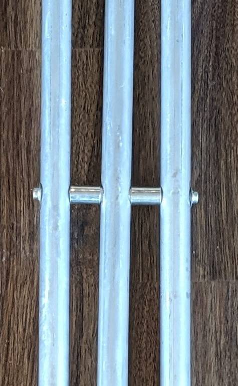

IMHO, you have two problems.
First, the small diameter of the pivot which, combined with the halves' long leverage, is seriously 'un-stiff'.
Second, the lengths of the slim frame will so make this bouncy. I reckon you need vertical or near-vertical struts between the floor and board horizontals. But how to make these adjustable ? Nest tubes to be telescopic, per walking stick or elbow crutch, fit spring 'cotter' clip through matching holes...
Several modes of vibration for the top
Translational - the top moves
1.front to back
2 left to right
3 up and down
Rotational - the top has a twist
4 in the horizontal plane ie about a vertical axis ( left end in, right end back )
5 in the vertical plane into the page ie about an axis front to back ( right end drops, left end rises )
6 in the vertical plane of the page ie about an axis left to right ( front end rises, back end drops )
Diagonal modes
such as the back right corner will move up, the near left will move down.
Just by inspection, it looks that all modes are possible, some more predominant than others, either due to rigidity, or lack thereof from the members, and torsional rigidity or lack thereof mainly about the pivot ( being pointlike ).
If you had ever noticed some of the collapsible chairs have the legs diagonally placed, which kind of alleviates the translational modes left/right, front/back. You could achieve something similar by extending the pivot out a good several inches out in both directions both front and back and attaching a member from the extension to each corner of the crossbar for the top and the bottom. That should alleviate some of the torsional mode of twist also.
For up/down vibrational motion the legs should be stiffened either internally as mentioned, or externally with a flat, or another round. Not sure if that will totally fix the problem.

Now that I see the design you are following I also see that you cheated and instead of using two tubes on both diagonals as shown on the original you only one tube on one of your diagonals, not a good idea because that makes that diagonal only 1/2 as stiff and twice as flexible in bending than the two tube diagonal.
Couple of differences I noticed between your design and the demo video:
1. they used larger diameter steel tubing vs. your aluminium. Since stiffness goes up to ^4 power of diameter along with 3x stiffer steel vs. alloy, their design (if identical) would be easily 128x stiffer than yours.
2. Table-top is attached to top legs creating triangulated section. Not sure how they did it, and they were careful not to load the table. Look into how ironing-boards lock the upper legs. If you can settle on several distinct heights rather than continuously variable, you can incorporate "claws" that latch to upper legs and form rigid triangle. This will go long way towards improving rigidity.
3. pivot. As mentioned, any looseness at pivot is magnified at end-points. Look at using larger-diameter sleeves in the tube with tight fit to attachment bolt. Brass or nylon-lined with tight-fit perhaps. Or weld in mounts for bearings. Press-in roller or dual-row tapered needle-bearings can be adjusted to remove any looseness at pivot while allowing rotation.

As far as the structural issues, I would agree the pivot looks small, and to be honest I think the alum tube is on the small side as well. The single tube on one side won't help. As mentioned already, if that was steel tube with the same wall thickness it'd be ~2.2-3x stiffer depending on alloys, conversely if something was intended to be steel, you need about 2.2-3x the material if doing the same thing with alum (rough guide anyway).

The pivot is not just pivoting, it has to provide stiffness in basically all axis here, so you have some small diameter steel rod trying to be bent by quite a long lever. Then the small pivot would put larger stress concentration on where the tube meets the pivot, and ally being soft as butter, will over time, probably not even that long "ovalize" the hole, which then rocks more, causes more ovalization and its a down hill spiral from there.
You could take the same material as the little sleeves you made for the pivot, drill the tubes out the OD of the sleeve, cut length to dia of tube and weld into the tube, now the pivot has the whole length of sleeve to work against rather than holes in the wall of the tube.
