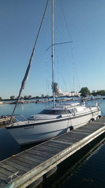

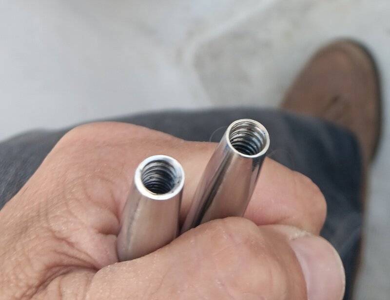

I bought four stainless steel turnbuckles to replace the vernier adjusters on the shrouds of my sailboat.
The cotter pin diameter is 1/4" - the same as what I am replacing. I was told that that is the metric by which one judges the capability of a turnbuckle.
They have a 1 1/2" long thread on each end and so can range from 6" inches to 9". Naturally, their functional range is less than 9". But my question now is: how much less?
On a test run, one of them blew out and almost dismasted me.
I checked once safely back ashore - the threads are stripped.
The left one is brand new. The right one looks like its threads are all stripped.
That's after one hour of sailing.
Two stainless steel turnbuckle barrels held in a hand, each showing internal threads at one open end, with a blurred background of a shoe and jeans.
Before I go back to the chandlery and complain it's a hardware fail, I have to be sure I didn't install them incorrectly.
I had made sure I had what I thought was enough turns. It was at least 5/8", if not 3/4" of an inch on each end. If that's not enough, that means the useful range of these turnbuckles tops out at 7 1/2" at best - barely 1 1/2" of range. I don't really have enough play in my shrouds to go much further than I have.
If I go a size up in turnbuckles, the next ones are too long - longer than the distance from tang to shroud swage, and I would have to remove and completely replace my shrouds.
What can I do?

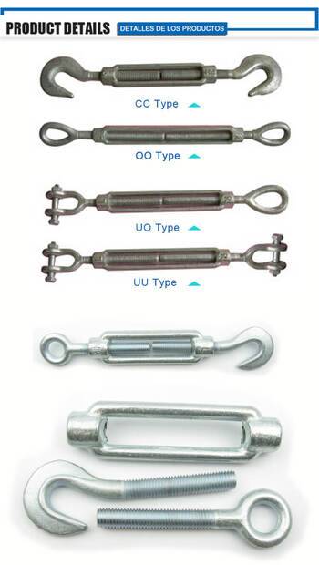

Looking at typical turnbuckles, you can deduce that approximately twice the diameter should be enough:
Product catalogue photo of galvanised turnbuckles in four end-fitting types labelled CC, OO, UO and UU, plus two loose hook and eye fittings with threaded rods below.
source: https://duckduckgo.com/?t=ffab&q=turnbuckle&iax=images&ia=images

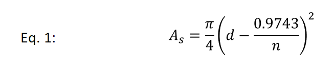

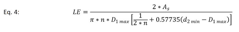

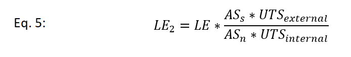

And then for even more precision, you can do the math:
Equation 5: LE2 = LE * (AS_s * UTS_external) / (AS_n * UTS_internal), with the fraction shown as a ratio of external to internal thread terms.
Equation 4 for thread engagement length: LE = 2 * As / (pi * n * D1 max [1/(2 * n) + 0.57735(d2 min - D1 max)])
Equation 3 for minimum thread shear area of internal threads: AS_n = π * n * LE * d_1 min [1/(2 * n) + 0.57735(d_1 min - D_2 max)].
Equation 2: AS_s = π * n * LE * D_1 max [1/(2 * n) + 0.57735(d_2 min − D_1 max)], minimum thread shear area for external threads.
Equation 1: As = (π/4)(d − 0.9743/n)², where As is the tensile shear area, d is the basic major diameter, and n is threads per inch.
Where:
LE2 = Minimum thread engagement length (tensile strength and shear area ratio)
UTS_external = Ultimate tensile strength of external thread material
UTS_internal = Ultimate tensile strength of internal thread material
AS_s = Minimum thread shear area for external threads
AS_n = Minimum thread shear area for internal threads
n = # of threads per inch
LE = Length of thread engagement
d_1_min = Minimum major diameter of external thread
d_2_min = Minimum pitch diameter of external thread
D_1_max = Maximum minor diameter of internal thread
D_2_max = Maximum pitch diameter of internal thread
A_s = Tensile shear area
d = Basic major diameter of external thread (in, mm)
source: https://www.omniamfg.com/mechanical...ate-fastener-minimum-thread-engagement-length

I have been told that full strength is obtained with seven turns. But with fine threads, I prefer to use one outer diameter, the length of a nut.
The threads on the rods were probably rolled, not cut, and so will be rounded and under-size at the ends. You might need to cut off the rolled end with a cutting disc to get a constant full thread OD. That will allow closer contact between the screw ends, with good thread when short. If poor LH and RH threads at the ends meet, they will reduce the range of adjustment.
Lateral vibration of a tight stay in the wind will produce very high axial forces on the turnbuckle, due to the triangle of forces being long and thin.
This is also a special case since each lock-nut is working with the rope tension to strip the thread.
If you adjust the turnbuckles under load, without lubrication or an anti-seize compound, the stainless steel threads will probably gall. That may remove some of the thread OD material, just where it is most needed. That could generate the damage you show.

Interesting you mention this. My next question was going to be: should the bolt be loose in its socket?
There's definitely a little play in these turnbuckles. I can wiggle them around a tiny bit, at almost any extension.
My naive thought when I observed this was 'Hey, doesn't that mean the threads are not fully overlapped? Isn't that weak?' But who was I to argue with marine-grade hardware?

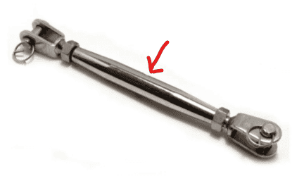

The screws don't touch in the middle. There's a hole for a lever and locking wire.
The shaft is 4" long and the screws have 1 1/2" of thread.
Photo of a stainless steel turnbuckle with a fork end at each side, a red arrow pointing to the central barrel.
I guess I could cut 1/4" - 3/8" off, but that doesn't solve my problem, does it? I don't have the option of screwing the turnbuckle in more than it is now. All I would be doing is cutting off useless thread.

I think this is exactly what happened.
I adjusted them at-dock and only hand-tight. Nowhere near as tight as the shrouds are recommended to be.
In fact, one of my theories was whether not having the rigging tight enough could have caused enough wobble to wear the hardware.
My take-away here is that - despite being sold in a marine chandlery, where they tend not to cheap out on hardware - these are cheap turnbuckles, and failed for that reason.

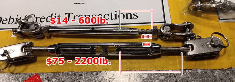

Interesting. That turnbuckle I posted a pic of is selling for $75.
The ones I bought are $14.
Meme image of two men seated side by side, one in a flat cap with arms folded, the other in glasses and a dark shirt laughing, with the caption "WELL THERE'S YOUR PROBLEM" overlaid at the bottom.
In fact, my 20/20 hindsight is reminding me that the reason I didn't do this upgrade years ago is because I was looking at $75 turnbuckles, and this time my critical judgement failed me and I bought impulsively,.
This site has the exact size and type, and calls them "Economy". "600-lb working load"
https://ca.binnacle.com/Turnbuckles-&-Accessories/c147/p11499/Stainless-Steel-Economy-1/4"-Turnbuckle-Tubular-Jaw-&-Jaw/product_info.html
  • Sad
Lemme make sure I understand this setup correctly: these turnbuckles are adjusted at the dock/while moored and not while under load, and are being used to make fine adjustments before/after sailing?
Given the specified thread engagement depth and the diameter, and the quoted price, I think the hypothesis that it just overloaded the material is the most likely one.

Look at the difference in thread length (and thus range) and in thread fineness (and thus strength):
Two stainless steel turnbuckles side by side, the upper one with a shorter, coarser thread and the lower one a longer, finer-threaded body with a central barrel; red annotations show thread lengths and price and load labels reading $14 - 600lb. and $75 - 2200lb.
And the premium turnbuckle only needs 1/4" of thread engagement because it's so strong.
I think Baluncore was spot-on when he suggested the "Economy" one was rolled steel rather than cut, and therefore the threads are poorly-formed and shallower. They can just pull right through under load.
Yes.
Stainless steel is hard to cut with steel tools because it rapidly work-hardens. That is especially true of marine grade 316. Grade 304 is designed to be easier to machine, but is not as resistant to chlorine, so 304 is more suited to inland waterways. The machining of stainless steel has become easier since the advent of carbide and ceramic threading inserts.
You can recognise a rolled thread because, being a deformed surface, the thread crests will have a slightly greater diameter than the shank. The rolled thread root is also more rounded, which reduces stress concentration at the critical minimum diameter.
The two turnbuckles, shown in that post #20, appear to have thicker shanks, so were probably cut in an NC lathe.
Both machine cut, and rolled threads, have an initial taper at the end of the threaded rod. That makes it easier to align and start the thread in a nut, but by reducing the height of the tooth, it reduces the strength of the thread at the end of the rod. I believe that is what caused the failure in the OP case.
I don't quite understand the details but it sounds like you're referring to the bolt rather than the body of the turnbuckle. It is the body that has stripped threads. The bolt seems to have fared all right.
One them is $75, the other is $14. Do you mean you think they are both manufactured the same way?
Or am I misunderstanding what you mean by "the two turnbuckles"? Do you perhaps mean "the two bolts of the $75 turnbuckle"?
I think so too. The $14 one is quite loose at the first few threads. But I assumed that that's why I was making sure I had at least 5/8" - 3/4" threaded on.
The $75 one actually has significantly less thread contact. The overlap area is fixed, at about 1/4" - much less than the $14 one had.
I refer to the bolt. If the bolt threads are undersize, with crests removed at the end, they will contact less of the body threads, and the narrow tops of the complete body-threads may then be pulled out, by the thicker remaining bottoms, of the bolt threads.
That takes some thinking about, but it does explain why a good internal thread can be stripped by an undersize bolt, one that is missing the crests to make it easy to start.
I think the bolts in both were threaded by machine cutting, but I cannot see diameters clearly in the photo. You need to compare the thread diameters to the shank diameters. Rolled threads use less material than cut threads, because the rolled shank is thinner.
A turnbuckle has two opposite threaded bolts, I refer to the 4 bolts in two turnbuckles.
In either case, the length of thread contact will be sufficient.
The $14 one has a tube with a thread in each end. The tube has been shrunk down at the end before being threaded. The actual thread will not go far up the tube, before the tube cavity opens out. That reduces thread friction, and prevents accumulated pitch errors causing problems, should the bolt stretch, or be bent slightly.
The internal thread need not be "cut" with a tap, it may have been deformed by a "threadflow" tap, which is an equivalent process to thread rolling on a bolt.
I hadn't really noticed a tapering of the bolt ends.
It would, yes.
I guess I could get pics, but not for a week. The only ones I haven't returned are currently holding my mast up.
Yes I just don't know which two turnbuckles. There's one $14 tb and one $75 tb. I guess you're saying they're made the same way.
Oh. OHHHH.
I just assumed the thread ran up through entire barrel. You're saying the closed barrels are only threaded for the first fraction of an inch. Just like the open barrel ones do.
Ohhhh.
Ah yes. That makes sense. If the thread contact is too long it will bind easier.
So the $14 turnbuckle might only have a similar 1/4" or so area of threading.
I was wrong : as it is threaded in, its strength does NOT keep increasing; it tops out at some point. And that's at 600lbs.(ish).
Got it.
For maximum adjustment range, turnbuckles are usually made with the two bolts, threaded long enough to meet in the centre. In the case of the tubular turnbuckle, the bolts should stop when they reach the hand turning rod, that passes through the hole, across the middle of the barrel.
DaveC426913 said:
I just assumed the thread ran up through entire barrel. You're saying the barrels are only threaded for the first fraction of an inch. Ohhhh.
If the thread went all the way up the barrel, it would take more work to manufacture, and there would be confusion when one thread met the other, with the opposite hand, coming the other way. Like the bindweed and the honeysuckle.
Michael Flanders and Donald Swann. 'Misalliance'. 1957
Yes.
Well, I didn't assume it went all the way to the centre. But I did assume it went essentially as far as the bolt could reach.
