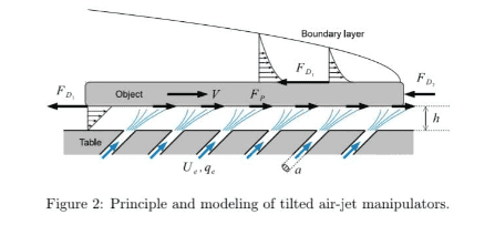

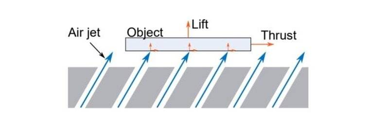

also for the sheet which will be the top surface that the air goes through to lift the object and make it move. I want to make the holes made in angle so when the air goes through it will help not just lift the object but also make it move along the bath. like inclined air jet how we choose the angle and how to calculate the forces acting on it.
I want to apply this concept but how do I decide the angles to drill these holes and and how to calculate and what formula to use

5) NOW you can use angled holes. Angled holes will move the boxes. I once saw literature from a company that was selling air conveyors that would move the product uphill, so it can be done. If you choose the large hole design, you can explore using louvered sheet similar to the image below. The louver shape will be different, and the sheet metal needs to upside down from that shown:
If you choose drilled holes, try drilling at a 45 degree angle, then experiment from there.
6) If you get enough experience with air float conveyors, you should be able to calculate air flow, air pressure, hole size, hole angle, and hole spacing. Those calculations will start with experimental data, then use standard fluid flow calculations to extrapolate that data to your specific requirements.
7) This is a situation where you absolutely, positively need to do experiments. Then compare the experimental results to your calculations. Then do more experiments based on what you learn. Expect to do the calculate >> experiment >> calculate >> experiment cycle several times before you fully understand how to design this type of conveyor.
