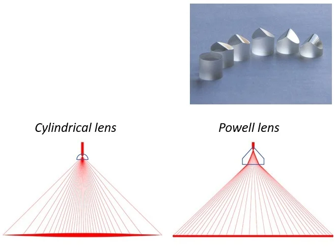

There are standard optical components used for generating lines from laser beams, known as Powell lenses. These lenses are manufactured with various divergence angles.
Diagram of a red laser module on a mount firing beams through five small lenses, each fanning out into a red sheet labelled 1°, 2°, 10°, 20° and 70°.
A typical laser beam has a Gaussian intensity profile. The principle behind a Powell lens is that it splits the laser beam into two parts and recombines them in such a way that the Gaussian profiles cancel each other, resulting in a uniformly distributed line. Powell lens assemblies allow the laser line to be focused at a desired distance, ensuring a sharp line with even intensity along its length.
Two ray diagrams comparing a cylindrical lens, labelled, which spreads a narrow beam into a short bright line, with a Powell lens, labelled, which spreads it into a wider, evenly lit line. Above them is a photo of several glass Powell lenses of differing angles.

I went ahead and got a Powell lens on Amazon. It seems to do the trick. It's a small lens. Any special holders with maybe camera thread adapter to stand up?

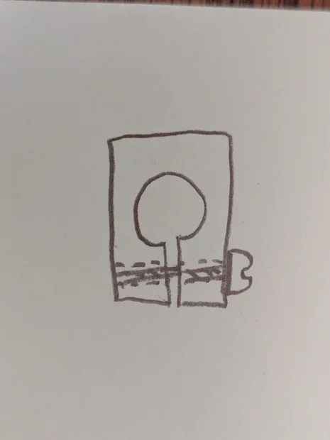

I'd rather not use glue on a $40 lens. I was thinking more a clamp of some kind? They have 3 nob tightener type clamps which can screw onto a tripod type thread?
If you are so inclined, you can make a good clamp with simple tools in a block of whatever (I'd use Aluminum). Drill a hole just a tiny bit larger than the lens, cut a slot, and squeeze it gently with a screw. Like this:
Pencil sketch of a clamp in a rectangular block with a circular hole for a lens, a vertical slot cut from the hole to the bottom edge, and a screw boss on the right side.
PS: Don't make the flexure side (opposite the cut) as large as I drew it unless you're a good machinist.

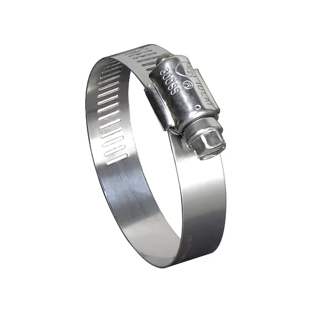

Also for an easy kludge, a hose clamp and foam tape around the lens. Not great in the optics world, but you get what you pay for. It'll work.
Stainless steel worm-drive hose clamp with a perforated band and a screw-tightening housing marked 80088.

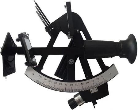

Historical woodcut of a man holding a backstaff, a navigation instrument, with a dotted line from the sun to the staff's sight vane and another to the horizon.
Black metal sextant with a silver arc scale marked in degrees from 0 to 120, a handle with an eyepiece at the lower end, and mirror frames with sight vanes.

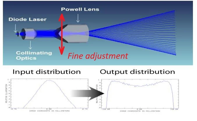

A Powell lens typically requires fine alignment in one direction, while it is insensitive to perpendicular displacements. We typically used semiconductor lasers with integrated focusing and a removable, adjustable Powell lens head, where the lens holder moved transversely to the optical axis in a Dove-type arrangement and was then secured with a screw.
Diagram of a Powell lens line generator: a diode laser feeds collimating optics, then a Powell lens fanning the beam into a wide sheet, with a red double arrow marked Fine adjustment; below, input distribution is a peaked Gaussian-like curve and output distribution is a flat-top profile.
