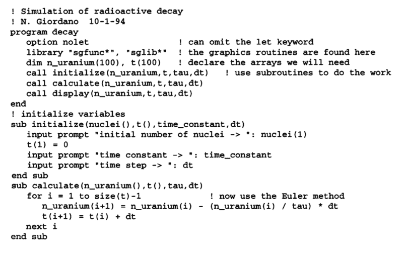

I'm taking Computational Physics. And I am trying to learn how to program in matlab. But I don't understand the author's code and what it is in MATLAB code. Can someone help me?

Do you know what language that is? It looks somewhat, but not quite, like FORTRAN to me. The code for the subroutines 'initialize', 'calculate', and 'display'. are missing. So there is practically no details there about what the program does. Are you talking about converting the entire thing to MATLAB or just this top level program that calls the subroutines?

It is True BASIC
and the whole thing. I think if I can see how it these basic things translate, I'll be able to translate the rest of the author's code more easily.

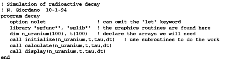

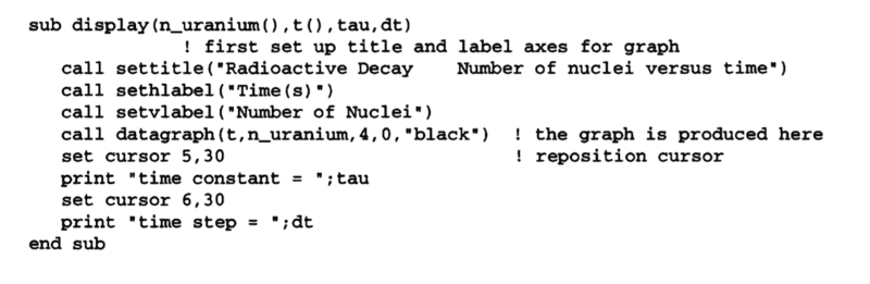

Wait I think I found them. Individually, but I think this puts them all in the same program?

Everything there is fairly easy to do in MATLAB unless you want to exactly mimic the graphing and display part. MATLAB has very good graphing capability of its own but it will not look exactly the same. MATLAB is very powerful and popular (within Physics and Engineering), so unless you already know other languages, it would be a good one to use. It's not free. Do you have MATLAB available to use?

It has to look exactly like the graph in the book. That's how we're being graded. if it is off by a little. if the colors are wrong, if the title is wrong, the fonts, he position, the spacing, whatever. she'll give it back and tell us to try again.

I use True BASIC routinely, and that is indeed what this code is. It is a very powerful, flexible, and easy to use language. When my last employer required everything to be done in Matlab, I would first get it running in True BASIC, and then convert to Matlab, a great waste of effort, but easier for me than working in Matlab.
The main program is the first 10 lines, down to the END statement. There are three external subroutines called INITIALIZE, CALCULATE, AND DISPLAY. The calling arguments for each are shown in the main program, and they correspond one-to-one to the lists in the subroutine declarations, even through the names are different. Thus, the first calling argument in the call to INITIALIZE is n_uraniaum which was previously dimensioned 100 in the main program. In the subroutine, the first argument is NUCLEI() where the parenthese tell the code to exxpect a one dimensional array.

The original program includes a (less than helpful) comment that says about sgfunc and sglib that they are found "here" wherever that is. Without them, you don't have the whole program.
You have two options: (1) go look for where "here" is and get those two routines, or (2) figure out what they do and write them yourself.

I vaguely recall seeing a reference to "sgfunc" in the past, but it is not anything I have ever used. There is also a call to a routine "datagraph" that it seems you do not have. You are probably going to have to write some code, but it is really easy to do. It appears that the real work of this program happens in "sub calculate." Get some examples of coding in TB, and follow them to write your own plotting routine.
As I think about it, I believe that "sgfunc" and "sglib" are both routines that are part of the Gold version (many more $$$ than the Bronze version), and probably not available in Bronze. You really do not need either of them. Remove the call to "uranium (...)" and write a short loop including a plot statement to draw the graph you need (FOR i=1 TO n // plot x(i),y(i); // next i) where // means a new line of code. The semicolon is required to connect the dots. You can plot the labels using the statement PLOT TEXT, at 12,15: "This is the text to appear." starting at the points with coordinates (12,15).
