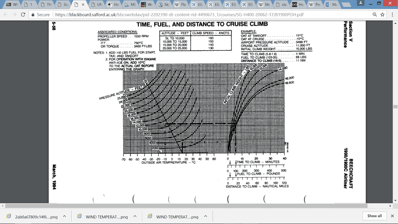

So i have an assignment to plan a flight from Heathrow to Glasgow and I am trying to calculate the time fuel and distance for the inital climb to cruise level and departing the airport, we have been given an aircraft manual and i have found the graph attached however i have calculated the pressure altitude at Heathrow to be -187 feet so how do i use the graph, any ideas? Thanks
  • Beechcraft 1900C time, fuel and distance to cruise climb chart plotting pressure altitude against outside air temperature, with time to climb, fuel to climb and distance to climb scales, and a worked example in the upper right.
mfb said:
0 feet and -187 feet are indistinguishable on the scale of the graph, just use 0.
Ah okay i had thought that might be the case but wasnt sure. Thanks very much!
