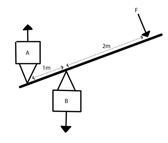

Lets put some directions on the forces...
Lets say F = 10N.
If the lever isn't accelerating in rotation then the net torque must be zero. If we define clockwise as positive then taking moments about point B we can write..
-(A*1) + (2*F) = 0
or rearrange that to give..
A = 2F
and so A = 20N
If the lever isn't accelerating vertically then the net vertical force must also be zero. If we define up as positive then we can write..
(-A) + (+B) + (-F) = 0
or rearrange to give
B = F + A
= 10 + 20
= 30N
Those arrows really helped, Thanks, I appreciate the help. I've not disappeared I'm just trying to solve my original picture with the two levers in sequence.
What I am confused about is that the clamp or anything you try to pry something apart with always applys equal pressure to both sides. If I push a lever, a crowbar between two posts and apply pressure it dose so to both sides equally, I thought? But in the examples like the one above you showed A and B are different? A=20N B=30N.
So in this picture: If A and B are the two surfaces and the lever a crowbar it should apply equal force to A and B. Whats the difference between my problem here and the example you gave?
So if F is 10Nt then A and B must both be 20Nt? I think the confusing thing is the idea of a kind of balance or see-saw with weights on ether side when I'm looking at a clamp between two surfaces. There is no up or down.

Yes, because both surfaces you're trying pry apart have the same lever arm.
In your drawing the two posts don't have the same lever arms. If A is the fulcrum, a 10 N force downward at the right end causes a 30 N force downward at B. If B is the fulcrum, the same 10 N force downward at the end causes a 20 N force upward at A.
So if A and B are round steel posts seen from above and the black line is a bar and I pull at F which is the fulcrum? I don't understand how there can be two answer to the problem. The only variable in the drawing is how much force you apply to the lever is it not?
OK I think I understand. By fulcrum you mean one is fixed, say A and then the lever turns around it against B or B is fixed and the lever turns around it against A. But this is back to the same problem. They are both fixed. Like the clamp applying pressure to the inside of the fitting. They are both the fulcrum. Again if A and B were unmovable unbreakable scales giving a reading and I applied 10Nt to the end of the lever then what reading should I get at A and B? 20Nt?
Here's my understanding, which others are free to refute (it's been many years since I took a physics class);
Since the force against B will be 50% greater than the force against A, the post at B will be the one that is most likely to give. That's assuming that both posts resist with the same force.
Do you understand where I got the 50% figure? If not, around post B, the force applied to A is twice the force F, because one lever arm is 2 m. and the shorter lever arm is 1 m. Around post A, the force applied to B is three times the force F, because one lever is 3 m. and the shorter lever arm is 1 m.
So if I take the scales example the reading I will get at A will be 20Nt, this is clear, but the reading at B your saying will be 30Nt. That derived from the length of the lever times the distance between A and B? I must be confused because that dose not seem to make sense, the force at B would increase the closer B got to your hands which is the wrong way round. How did you get the 30Nt at B?

If you imagine the goal is to exert a 10 Newton force on A, then the closer B is to your hands (where force F is applied) the more force you would have to exert there to accomplish that goal. So it makes sense that the force on B would increase.
You are imagining a situation where you have picked a force to exert with your hands and you are willing to let the forces on A and B take whatever values are needed to balance the situation. In that situation, it is true that the closer B is to your hands, the less force is exerted on A (and thus on B).
You can see the diagram in #21 must be wrong by looking at the external forces...you have 90+10=100N acting downwards and only 60N upwards so there is a net force of 40N downwards. It implies the whole assembly is accelerating downwards.

Correction: I made a mistake with the directions, that should be 60+10=70N downwards and 90N upwards. Still doesn't sum to zero so it's accelerating.
I don’t understand the accelerating downward bit, it’s a clamp restricted between two scales it can't go anywhere and I don’t see why it has to be balanced. If I had a fitting with a bolt that you tightened so it came out of one side then all of the force would come from that point but as it did so it would push it’s self against the opposite side so the force would be equal on both sides, in a 2D representation. Though different amounts of force are applied on both sides I then add them together and divide it by 2 to give the results on the scales. Here’s another go at:
dose this one look right?
Or do you mean both side have to add up to the same no matter what?

Which is not how it works. In this drawing, there's a force of 90 N on the upper scale, and a force of 100 N on the lower scale. If the upper scale reads 80 N, then that's the upward force, and similarly for the lower scale.
If the system has a net force in some direction, then it will accelerate in that direction -- F = ma is the basic equation here.
