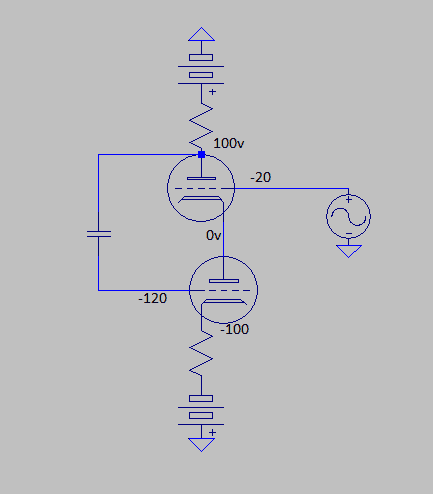

I have a question about relative voltages and operating points of components, in this case tubes.
Are these two functionally the same?

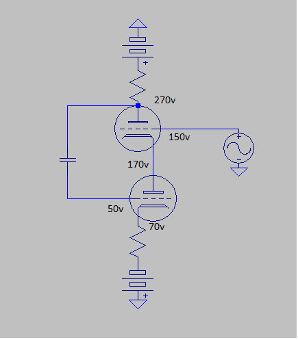

For a while now I never could understand how the bottom triode of the WCF in an amp I bought was biased at -100v on the grid and 0 volt on the plate which would put the tube way into cutoff. It just dawned on me that since the cathode is -75v then 0v is effectively +75v on the load line for the triode and -100v is actually -20v.
It then occurred to me that if 0v = +75v as far as the triode is concerned then can high positive voltages relative to other parts of the amplifier be considered low voltages in the WCF? For example the picture on the left, to each triode the relative voltages are the same as the voltages on the right.
Does this mean that they would both function the same? In this case is 170v on the output of the left picture effectively the same as 0v to a speaker I hook up to it? (Assuming the other end of the speaker is also 170V)
Or perhaps if I connected the picture on the left directly to a 150v input stage would it still be considered the same as the picture on the right as far as the tubes are concerned?

From anything I can see, the second one just has 170V subtracted across the board. As such, it should function exactly the same.
Unless, you have a fixed ground somewhere that is 0V in both cases. Because then you introduced a common reference point, and when you then subtract 170V in one, the potential differences towards ground are now different.

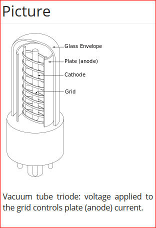

remember voltage is potential difference
start at the cathode
an electron that's just been emitted into the space charge surrounding the cathode of any of those four tubes
sees a control grid that's 20 volts negative wrt cathode
and beyond that grid, a plate that's 100 volts positive wrt cathode
if it can squeeze between those negative wires of the control grid it'll accelerate toward the plate.

Electrons inside the tube are oblivious to "ground", they respond only to the fields arising from potential differences between cathode, anode, and grid.
Your left and right circuits are equivalent for AC provided your AC voltage source does not pass DC.
An ideal voltage source, as might reside in a simulation program, ought to be a short circuit for DC.
