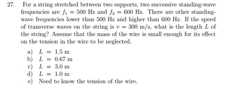

Trying to find the length of the spring. But i can find the tension of the wire at all.
I'm not sure what i can do with the frequencies? Maybe I'm forgetting a concept cause i thought the equation v^2/F = L would give me the length and since i can neglect mass of the wire.
I'm am just super stuck!

What is the relationship between frequency and wavelength?
For a given length of wire, what wavelengths of standing wave can there be?

You do not know that the fundamental frequency is 500Hz. What you do know is the frequencies of two consecutive harmonics.

For frequency 500, v =500lambda , lambda= 3/5
For 600, lambda= 1/2
6/10-5/10= 1/10 m wavelength difference between the two consecutive harmonics. Is this info any helpful?
Ok, I could not understand your previous post because you left out the units.
Yes, the difference in the two wavelengths is indeed 0.1m. But you have not used the fact that these are consecutive harmonics. If a string has length L, what are the possible wavelengths?

If the string length is L, what is the wavelength of the fundamental? What is the wavelength of the next harmonic?
I think the wavelength is 2L = lambda. for fundamental
next harmonic is L = lambda
Right, so what about the nth harmonic?
Lambda = 2L/n?
lc99 said:
Lambda = 2L/n?
Right, so if two consecutive harmonics have frequencies 500Hz and 600Hz, which two are they?
5th and 6th harmonic?
Right. So how do their wavelengths relate to L?
for 5th harmonic, wavelength = 2L/5
for 6th harmonic, wavelength = 2L/6 = 1L/3
Right. So what is the length L?
Okay, 1.5 m? right. And it's because we know that consequtive harmonics help us find the n
Right.
