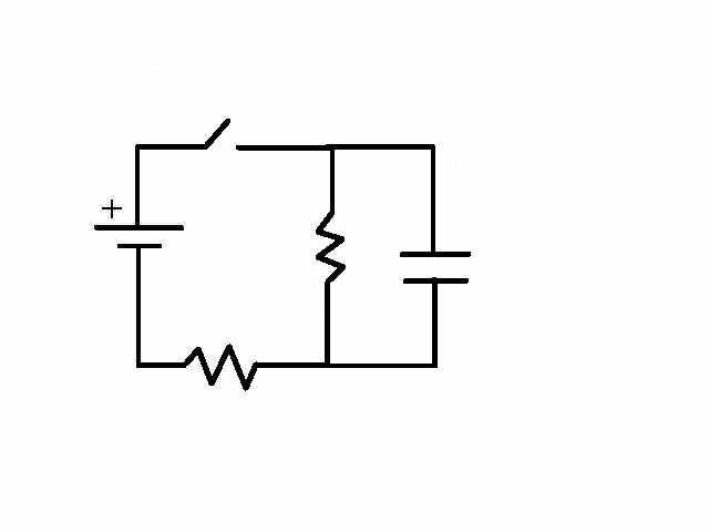

in this circuit when the switch is closed for a long time...
the capacitor will charge correct?
Bulb A will continuously be lit correct?
Im not sure what happens to bulb B, will it light then dim itself a little because of the capacitor or will it light as bright as A ( bulb A and B have the same current) ?

Sorry bulb A is the resistor parallel with the capacitor

After the switch is closed for a long time both bulbs conduct the same current. The capacitor is charged (to half the battery voltage --- the same voltage that appears across bulb A).
When the switch is first closed the capacitor is uncharged so there is 0V across it. Bulb B then gets the full benefit of the battery potential for that initial instant, while bulb A has zero voltage (and thus no current). As the capacitor charges and its voltage rises, bulb A conducts current. Bulb A brightens while bulb B dims, and they "meet in the middle" with both bulbs running at half brightness and half the battery voltage across each.
