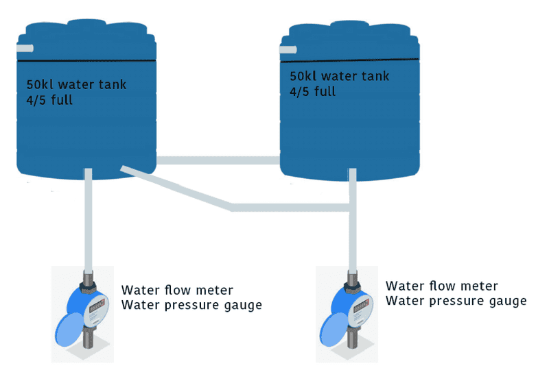

Hi guys. This is my first post here. I love physics but I am unsure how do model water flow type of problems. If anyone could please help us with how we can analyse this it would be much appreciated. It not homework but a problem we are having on our property with water flow.
Please see the diagram I made below for our current situation. There are 2 outlet pipes that go to 2 pumps and would like to know how much additional water flow and pressure the outlet that is connected to both tanks would have? I do not need a precise answer but would like to know physically how i would model this and if it would likely have much more flow (as in 10% more 20% more or 50% more etc) Note: I do not need to know the actual exact water flow value but more of a percentage likelyhood - that's all
2 large water tanks equally filled (notice coupling pipe between them) supplies water to 2 different outlets at the bottom. One received water from only 1 tank, and the other from both tanks at once.
Additionall info:
- Both water tanks are on flat ground and filled to the same level
- All pipes are of same diameter
- All outlets and coupling are at the same height from ground
Is anyone able to help me model this please? I have never done any water flow type of problems in physics and not too sure where too being.
Thank you in advance :)

Your system is pressure driven; with a bernoulli equation and pressure drop calculations you should be able to get some results. Provide a lot more detail (drawings, pipe data) if you want an example.
If the pipe between the tanks is wide enough, both tanks should empty at the same rate.

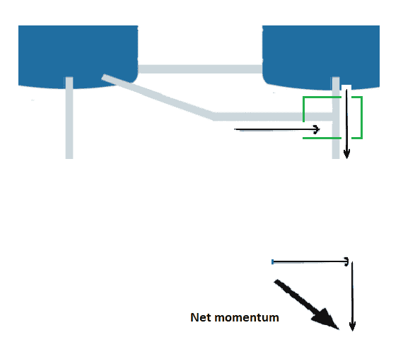

This brought me to the idea of analyzing the water (lets pretend its inviscid) and instead of water atoms, could we model them as tiny steel ball bearings and use a basic Newtonian model.
All the ball bearings have a force on them due to gravity. The movement will be complex like fluid dynamics but it is not hard to see at the point with the T intersection there will be momentum from 2 directions joining together.
Please see this demonstration I made
And this resulting momentum should cause the ball bearings to bounce off the insides of the pipe and cause an additional flow of balls at the output (compared to the output that doesn't converge from 2 tanks)
Similarly, this system should produce very similar results to a situation where there is only 1 tank and one output has only 1 output from the tank and the other output has 2 outputs from the tank.
I'd love to know what you guys think of my simplified analysis
I don't think the steel balls are a good analogon for fluid flow.

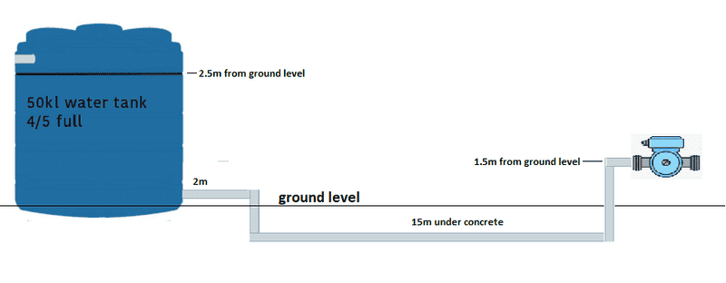

Hi mate. I did a quick sketch.
I've only shown 1 tank to simplify it a little. So the large water tank is a reservoir we use in case we run out of mains water pressure. The large tank feeds the pump you see on the right (this is actually for an automated carwash)
So the PVC pipe length in total I would say would be somewhere around 20m in total and I believe the pipe diameter is about 50mm (I might have to check on this tomorrow morning though when Im there)
You asked, cavitation or rattling. Personally I think the problem may have started off as cavitation and over a couple of years it's escalated to metal on metal rattling. I do not know if the lack of pressure has caused damaged or not
The actual pump specifications are on here https://arimitsupumps.com/wp-content/uploads/2022/12/model_TR709KV.pdf
It states on there inlet pressure should be -5 to 70psi.
If the pump is trying to feed in water fast and there is not enough pressure keep up, cavitation will defiantly occur near the inlet and will cause damage to pump for sure. I do not know for sure that's what happened but its a possibility

With 15 GPM (10-3 m3/s in understandable units) typical flow and 1.25 times 25.4 mm pipe diam you have input info for the engineering toolbox goodies to estimate pressure drops (which may or may not be important in this casus).
Hi mate. yep the single 50mm pipe that travels underground which actually forks off to 2 identical arimitsu pumps. So it needs to supply enough pressure for both
We have another site where the reservoir tank is positioned on the 1st floor of our building and pump on the ground floor so there is a lot of pressure on the water where the pump is located. Because of this the pumps make half the noise of the pumps at the site with the green tanks explained in this post.
This tends to make me think it is indeed cavitating to some extent. However I dont know if cavitation would be enough to eventually cause metal on metal damage. Usually cavitation has a much greater effect on the rubber seals of the pump.

A diagram of the total system from inlet (the open reservoir surface) to outlet ( where the water exits the pipe) would be necessary to do some calculations. I’m skim reading a bit on my phone, but it seems like you are only giving a partial schematic. Here and there.
They don’t have to be fancy, just some lines and labeled boxes to start. Elevations (relative) are important. Pipe lengths/diameters. All the pump(s) performs curves. With the parallel flows, pumps etc it can be tedious to solve the resulting nonlinear system. However, maybe something useful can be found even if we don’t get that far.
If you are having difficulty, I try to draft up an example highlighting the important info. to a made up system for reference.

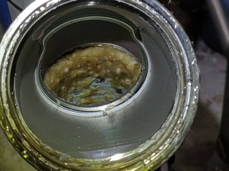

Thanks erobz. I noticed last night the fine mesh on one of the filters was partily blocked and after cleaning it has reduced cavitation quite a lot. I think we will pay a plumber to come in to add the additional feed and also to use a drain cleaning device to try to unblock the pipes in case they are blocked. The seem to have a lot of calcification from the normal water and possibly organic type matter inside from dead birds etc.
I have a photo. Any guess what it might be?
If we still have issues after that we will illustrate a through diagram and try to go through all the math :)
Looks like something biological to me. Is it squishy or rock like? Thats the extent of my troubleshooting experience with that stuff though. I would have to use my "phone a water treatment friend" lifeline.
It's not rock like, it is soft and squish so I also believe it is some sort of organic matter. We will see if the plumber can use the cleaning oscillating tool to scrape it all out.
