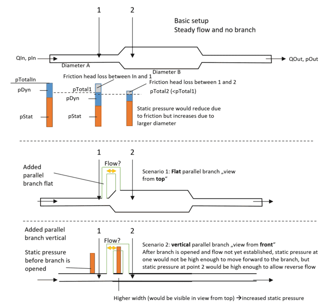

Hello!
I have a question regarding the application of the bernoulli equation and calculation of the flow through a parallel pipe branch. It's more the basic understanding how the flow will establish.
You can find a sketch attached to follow my explanation.
Let's assume I have a pipe with diameter A, which gets larger to diameter B - let's assume in width so the height is negligible - and then smaller to diameter A again. There is a liquid flowing through the pipe, e.g. water.
There is a small head loss in the pipe due to friction, so pOut will be smaller than pIn obviously.
Now at the part where the diameter expands from A to B, the static pressure has to increase because the kinetic energy is reduced due to the larger diameter according to the Bernoulli equation. If the friction is low, this will "overcompensate" the decrease due to friction and I can see a higher static pressure at point 2 than in point 1. Note: If the diameter had stayed the same, static pressure at point 2 would have been lower than in point 1 because of the friction.
The total pressure that consists of the static pressure and dynamic pressure has decreased nevertheless due to the friction. I hope it's correct until here.
Diagram of a pipe with diameter A widening to diameter B and narrowing back, with pressure head bar charts at points 1 and 2 and a flat or vertical parallel branch added between them.
Now I wonder about two scenarios, if a branch is added between point 1 and point 2.
Scenario 1: The branch is flat on the ground.
According to pipe network calculation theory, the head losses in both branches should be equal and the flow will align to match that. So this means there must be a flow in the green painted branch from point 1 to 2. But, intuitively, I'd say that if I open the branch when it was in steady flow before, the fluid would rather try move from point 2 to back to point 1 through the branch as the static pressure is higher at point 2? Or is this some transient behaviour and in the end there will be a flow from left to right in both branches? In hardy cross it would not be possible to have some kind of reverse loop to my understanding. Also QIn must still equal QOut and the total pressure pIn is higher than pOut, so there could only be some internal loop.
I know if I apply Bernoulli between 1 and the upper branch and between 1 and the lower branch it must yield the same energy for both branches - but I don't know if the flow will establish at all like I expect or not to be ablw to draw the streamlines?
Scenario 2:
I modified the example 1. I have basically a similar setup, but this time the branch is added vertical and not flat.
Let's imagine the branch is not opened yet. At point 1 if I insert a vertical static pressure measuring tube (at the wall, parallel to the flow, I just imagine a thin long glass pipe), the water level would rise as high as the static pressure allows - it is not high enough to flow through the branch to point 2 (or out of the measuring tube). If I measure at point 2, the water would rise high enough to be able to flow through the branch and then down to point 1.
Here, I have the same confusion. Seen as a pipe network, I would expect the flow to be from left to right in the main pipe (lower branch) and also in the upper branch (with different velocities depending on friction and branch geometry). But, it seems it will rather flow back from 2 to 1. I could only image it flowing from 1 to 2 if I regard the total pressure which is higher in 1 than in 2.
So here I'm really confused how the flow will establish:
A) Flow from 1 to 2 - but the static pressure when opening the branch isn't high enough in 1 to pass the elevation?
B) No Flow - I can't imagine that as the static pressure in 2 is high enough to lift water as high as the horizontal part of the branch
C) Flow from 2 to 1 - Doesn't match my expectation about pipe analysis and would violate that there should be the same head loss through two parallel branches
I hope you could understand my problem and I hope to get some understanding how the flows will establish and why!
Thanks a lot in advance
PS: I know usually the kinetic pressure part is small and can often be neglected, but I want to understand it completely first.

If we apply the Energy Equation between ##1## and ##2## for the main branch ##A##:
$$ \frac{P_1}{\gamma} + z_1 + \frac{Q_A^2}{2 g A_1^2} = \frac{P_2}{\gamma} + z_2 + \frac{Q_A^2}{2 g A_2^2} + k_A \frac{Q_A^2}{2 g A_1^2}$$
##k_A## is a loss coefficient for the expansion.
##z_1 = z_2## on the pipe centerline
This implies that:
$$ \frac{P_2 - P_1}{\gamma} + \frac{Q_A^2}{2 g}\left( \frac{1}{A_2^2} - \frac{1}{A_1^2} + \frac{k_A}{A_1^2} \right) = 0 $$
Nothing jumping out as peculiar there that I can see, but try to poke holes in it.
Now, It seems to get goofy in the small looping branch equation: just assume a straight pipe of cross-sectional area ##A_B##:
$$ \frac{P_2 -P_1}{ \gamma} + \frac{k_B Q_B^2}{2g A_B^2} = 0 \implies $$
$$ \frac{P_2 -P_1}{ \gamma} = - \frac{k_B Q_B^2}{2g A_B^2} $$
The LHS is positive, while the RHS is negative...

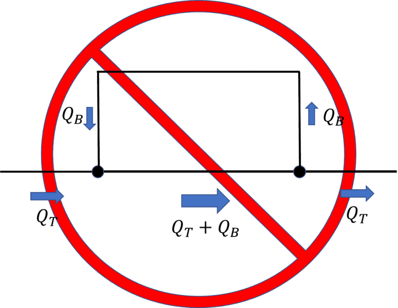

One thing is clear about the possible direction of flow: Matter cannot be created!
Diagram of a horizontal pipe with a rectangular branch loop above it, a red prohibition circle with diagonal slash over it; arrows labelled QB point down and up in the branch, QT points right on both sides, and QT + QB points right through the centre.
As you can see with this configuration, we have spontaneously created matter ##Q_B## in addition to the total flow ##Q_T##. So it can't flow backward like that.
"No flow" at all also seems strange because there would be a pressure gradient along the length of the branch...but no flow...
The question left to answer: Does it flow forward? Time to solve the system.

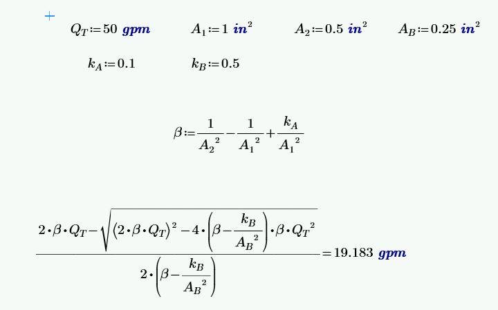

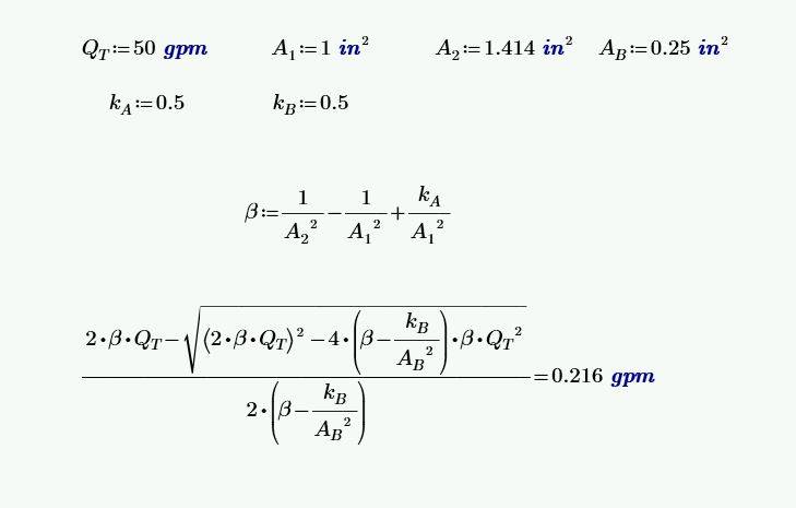

I think the answer is we can get flow, but it depends on all the parameters. At least that is what I'm being told by the solution. Shrink the downstream pipe ,or don't change size; no problem, branch ##B## gets flow. However, increase downstream pipe diameter too much for a certain set of parameters...and flow in ##B## stops.
Here are some sample parameter sets:
Worksheet equations: Q_T := 50 gpm, A1 := 1 in^2, A2 := 0.5 in^2, A_B := 0.25 in^2, k_A := 0.1, k_B := 0.5; beta := 1/A2^2 - 1/A1^2 + k_A/A1^2; and a quadratic-formula expression in beta, Q_T and k_B/A_B^2 equal to 19.183 gpm.
Mathcad worksheet defining QT := 50 gpm, A1 := 1 in^2, A2 := 1.414 in^2, AB := 0.25 in^2, kA := 0.5, kB := 0.5, the expression beta = -1/A2^2 - 1/A1^2 + kA/A1^2, and a quadratic-formula expression for flow, evaluated as 0.216 gpm.
I think the gist of it is because of the head losses through the expansion, the pipe can be larger to some extent downstream, but the pressure ##P_2## still lower than the pressure ##P_1##. You’ll notice that for any flow to occur in branch ##B## , ##P_1 >P_2##. That can’t happen in “Bernoulli’s” because there are no viscous loses.

I think you still are confused about that scenario.
10 heads into node 1, 11 (10 from the main, 1 from the branch) comes out of node 1 (heading towards node 2). 11 enters node 2, and 11 leaves node 2 (10 in the main, and 1 in the branch). We have created 11 from 10.
If none enters from the branch at node 1 (which is what you are saying), then none can exit at the branch in node 2.
That was my thinking, I think it was maybe confusing because I more thought it as transient until it can become steady.
So you were thinking about it being an empty pipe initially. Why should it bypass node 1 before the flow splits in that case? The pressure at node 1 would be initially higher than the pressure inside empty pipe downstream. flow would be established up node 1 before node 2.

If you agree I would conclude: As long as ##A_2<sqrt(2)## that is solvable. Once ## A_2>sqrt(2) ## the value inside ##\sqrt{(2*\beta*Q_T)^2 -4*(\beta-\frac{k_B}{A_B^2})*\beta*Q_T^2}## will become negative. I interpret this that the normal forward flow will occur until that, and afterwards it will most likely stop. But it would become very difficult to predict the exact transient behaviour as we only have a solution for the final steady state.
I think at least one criterion is to keep what under the root non-negative. I didn't get what you did for the condition on ##A_2##.
$$ ( 2 \beta Q_T)^2 - 4 \left( \beta - \frac{k_B}{A_B^2} \right) \beta Q_T^2 > 0 $$
I took the second example you calculated above in post #9 and left all the other parameters constant except for the diameter ##A_2## and solved it. For other parameter combinations it would of course be other values as they influence each other. It was just valid with the other parameters unchanged.
Just solve it in general for any parameter set (it simplifies quite dramatically).

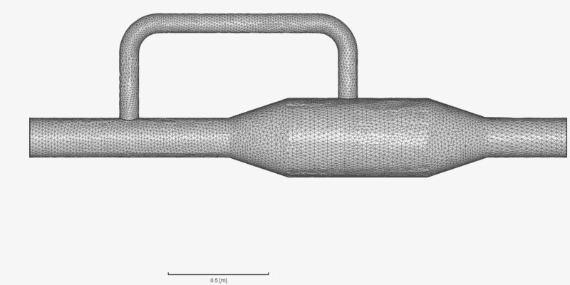

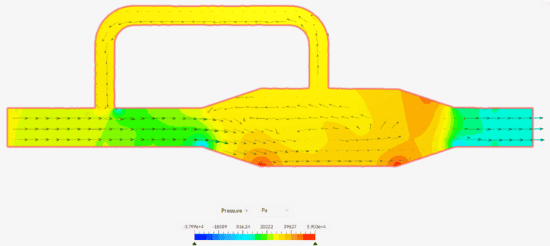

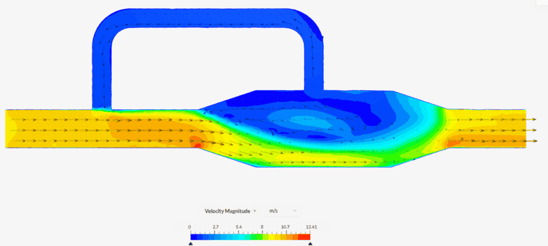

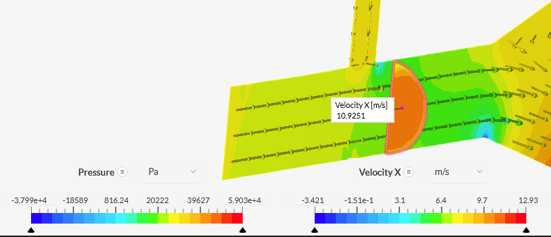

Just in case anybody's interested, I learned some CAD and modeled the thing in a CFD simulation :-)
Of course it's more far away from the initial theory in the post as it includes wall friction and a turbulence model, but just thought I'd put it here for completeness. Input speed is 10m/s and there is a (very small) backflow.
Mesh:
Mesh of a pipe network in side view: a horizontal pipe with a U-shaped bypass branch above, joining a wider expanded section with tapered transitions, with a 0.5 m scale bar below.
Pressure field:
CFD simulation of a pipe with a side loop and an expanded section, colored by static pressure from blue (low, -3.799e+4 Pa) to red (high, 5.903e+4 Pa), with velocity vectors showing flow left to right.
Velocity field:
CFD velocity magnitude plot in m/s of a pipe with a widened chamber and a bypass loop, colour-mapped from 0 to 13.41, with arrows showing flow direction.

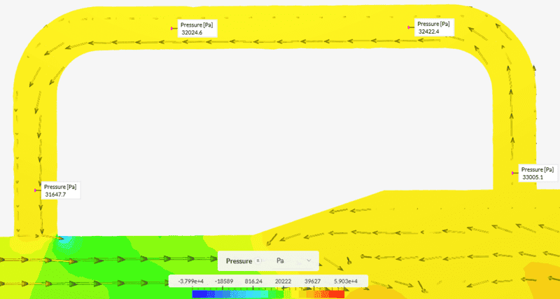

I don't know what to say, but I still don't think reverse flow is physically possible.

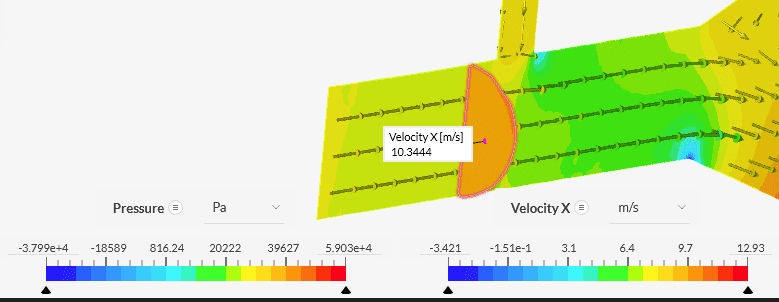

Is it possible to see a finer resolution on the pressure gradient along the length of top pipe?
Another thing: Can it give the volumetric flowrate in various cross sections? I'm most interested in that just before and after the entrance of the loop.
I think it gets compressed by the forum. I created some measurement points to show the pressure. Also I did a cut so we can look into the bypass from the front (rotating the model above by 90°).
Actually to me it looks a little bit like the recirculation area that is visible in a sudden pipe expansion. There it is caused by the friction and shear stress between the fluid layers (which I neglected in the original idea).
Pressure in bypass (Note: Boundary condition for outlet was 0 Pa and boundary condition for input was 10 m/s so atmospheric pressure would need to be added to the values).
CFD screenshot of a looping pipe with yellow flow arrows and pressure probes reading 32024.6, 32422.4, 33005.1 and 31647.7 Pa; colour scale from -3.799e+4 to 5.903e+4 Pa.
Cut and looking into the y-axis (bypass)
Speed is <1m/s. Bypass radius is 50mm and entry radius of the pipe is 100mm, so the recirculation would be less than 2.5% (less than 10% of the speed through 1/4 the area).
Simulation screenshot of Velocity Y in m/s on two probe points, colour bar from -4.92 to 2.967; left probe reads -8.97096e-1 (green), right probe reads 8.88533e-1 (yellow).
And here the x-speed (flowing "into" the pipe from left to right) at the junction at the beginning. Speed is slightly higher than 10m/s because speed at the wall decreases because of friction.
CFD simulation screenshot of a pipe junction showing Velocity X contour colours from blue to red with arrows, a probe label reading Velocity X [m/s] 10.3444, and a colour scale from -3.421 to 12.93 m/s; a Pressure colour scale from -3.799e+4 to 5.903e+4 Pa is also shown.
CFD simulation screenshot of a pipe junction colored by Velocity X in m/s, with arrow vectors showing flow left to right, a tooltip reading Velocity X 10.9251, and a Pressure colour scale in Pa beside it.
View attachment 316561View attachment 316562
I would like to find out what it thinks ##Q## is in those sections. Can it give us $$Q= \int v \, dA $$ for the sections you’ve highlighted?
