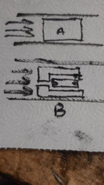

The question is pretty simple. There's a 4" I.D. steel tube with water flowing through at ~12mph. There is a choice between two cylinders. Both diameters are 3.8"; both appear similar externally except the top/bottom of #2. One is solid. The other has a 0.5" inlet on top which leads to another cylindrical solid. The outlet has more cross sectional area than the inlet.
Will each perform identically or will the latter be more effective? ("Grab more" water)

We need more information to help you. Without a sketch, I have no clue as to what you are trying to do. So please add a sketch.
What do you mean by "perform" and "more effective"? What is the purpose of the two cylinders? What is the purpose of this assembly?
Provide greater surface area to push the tool string downhole. "More effective" means using less water to achieve the same speed. So "perform identically" means the ideas for Cylinder B do nothing.
  • Hand-drawn sketch of two cylinders labelled A and B, each with arrows showing fluid entering from the left; B has an inner stepped shape inside the outer cylinder.

Nice use of a paper towel there. So this thing is used as a shuttle. It carries that thing inside to some other location in the system?
It's not a picture of the system but of the idea being explored. The reality is currently this part is made of rubber and can be used to assist the movement of the tool string. That is not its primary purpose... and rubber wears down fast. Also the rubber part is not designed to minimize wear.
Our tool string is essentially a 3.125" Cylinder that's about 60' in length and weighs close to 700 lbs. The part to assist us getting down hole is optional but helpful. Meaning that much weight (wet steel on steel) is pushed about 2 miles horizontally by water traveling at 12-15 mph (laminar flow) in a 4" ID steel tube.
Both my initial design and the rubber part are approximately the same height. If anything 1" is thicker than the rubber part.
There is a 2" "neck" about halfway in the string. Either part would slide over it and be locked in place.
I'm curious if Cylinder B provides more effective surface area to push against than Cylinder A. I have all these ideas to complicate the part, this is one of them.
However if complicating makes it work better (more speed for less water)... 👍

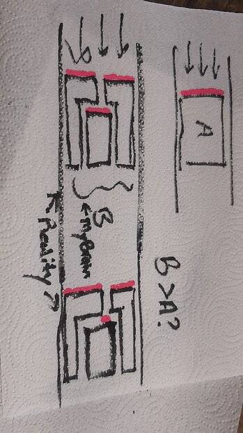

The question is depicted in the new attachment below. What is more representative of reality for the posing area for Cylinder B?
  • Hand-drawn sketch on paper towel of a pipe with arrows entering, showing two cylinders labelled A and B with a pink-highlighted top, B shown in two alternative shapes labelled Reality, and the text B > A?

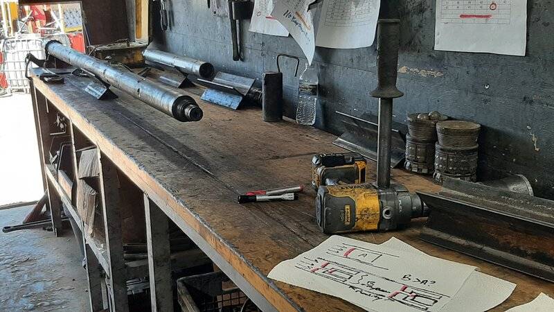

  • Photo of a workshop bench with steel pipes, a cordless drill, a hand tool and a sheet of handwritten sketch showing two cylinder labels A and B with a red-marked pipe layout.
You are slipping a "cup" over the cylinder to make it closer to the pipe diameter so the flow can apply more force?
You are talking about rubber cup or metal cup. You are saying its metal on metal friction, lubricated by water...where is that coming from?
Essentially.
Just take what's on the bench in the above picture of the work area and add on similar diameter items until 60' is reached.
In the other picture above... what is most true for B? Where pink is the pushing area. That's really what I'm trying to figure out.
"Because it's fluids" my brain leaned initially towards the left B. After drawing it my brain is at 50/50 only because it's holding out hope for the left side.
Even if I made the hole conical with the wide end at the "internal" cylinder the fluid must slow down as it enters a wider space... slower = less force. So ultimately is B equivalent to A? ( A = Right B)

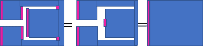

With the scenario B on the left there is also pressure acting on the opposite interior wall of the cup that you have not highlighted. If that extra area of the cylinder face is where you think any advantage could lie, there isn't.
Three side-by-side schematic diagrams of blue cylinder-and-piston assemblies with pink seals, joined by equals signs; the left two show piston and cup arrangements with fluid gaps, the right one is a plain blue block.
Furthermore,( for the same reason as above) you must consider the pressure acting on the front of cylinder. It is acting to counter the force that is pushing the cylinder. Flow must bypass to lubricate cylinder on its journey. At the front end the cylinder pressure form that fluid is pushing back. The pressure is lower, but it is the net force on an object which is important, so it needs to be considered.
Free-body diagram of a cylinder in a pipe with sections 1 and 2 marked by dashed lines; F1 = P1 · A1 pushes right, F2 = P2 · A2 pushes left, friction F_fr = μMg points left, and velocity v points right.
$$ \sum F = F_1 - F_2 - F_{fr} = M a$$
