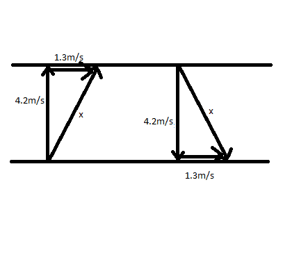

a)
Here is a diagram I made:
Left side of picture is there, right side is back
So should I solve for x, then take x, multiply by two, then divide by two. Thats the avg speed? because the question doesn't give any distance or time, so this is all I could think of.
As I read the problem, "across the river and back" to me means that he ends up at his starting point. Your diagram indicates he would end up 2.6 downstream. In order for him to arrive back at his starting point you would have to interchange the 4.2 m/s and x on your diagram.
yes you are right. I now get 4.2m/s as the penguins average speed for part a

I never answered part a but 4.2 looks wrong. 4.2 is his speed in calm water. I think the answer is the same as what you would have gotten in your original post: x^2 = 4.2^2 + 1.3^2.
Are you sure? I think skeptic may have a point about having to return to the same starting point.
Yes, but I think the answer's the same. He would start upstream by a certain distance and wind up at the starting point, and the velocity vectors would be the same as if he wound up downstream by the same distance.

Ok, well then in this case the avg speed is 4.4m/s
