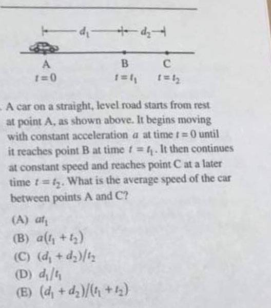

In the file below.
Speed= total distance over total time.
Acceleration = change of speed over time
[/B]
I tought it is just E because of the first rule above. But then I doubt my answer since it moved with constant acceleration first then constant speed. However, I don’t see thant any of the choices fit. Can someone help?
  • Diagram of a car on a straight horizontal road with points A, B and C marked, distances d1 and d2 between them, and times t=0, t=t1 and t=t2 labelled below, followed by a problem statement and answer choices (A) at1, (B) a(t1+t2), (C) (d1+d2)/t2, (D) d1/t1, (E) (d1+d2)/(t1+t2).
What is the sum of the distances? How much time elapsed in covering those distances?
Hint: for total time, try replacing t1 and t2 with numerical values to get an idea of total time in letter variables.
Is it not d1+d2 for total distance? Aha, the hint makes this clear; it is just t2.
Next time I will assume some values. Thanks a lot.
