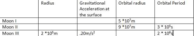

An Earth station receives data transmitted back in time from a future intergalactic expedition. The table summarizes the data for the moons of a planet that will be discovered in a distant galaxy.
Moon 1: only has orbital radius = 5E7 meters
Just only this information.
Question: the orbital period of Moon I is closest to:
Using Kelpers Law
Force = GMeM/R^2
How do I find out the orbital period if I don't know that acceleration, and the mass, and what's the difference between radius and orbital radius? I just don't understand what to do.

Here is the table, that might make sense to you.
The possible answer is 1.2 *10^5s. Not sure if that asks you a question.
You have period and radius information for Moon II. You could use Kepler's 3rd law to solve for the orbital period of Moon I by setting up the appropriate ratios.
Alright, so I use the ratio of Time to solve for time 2 using the Kepler's 3rd law.
So For example,
Tm1/Tm2 = kepler's third law?
m1 = moon 1
m2 = moon 2
Is that right?
I think I got it. Finding out the ratio of Tm1/Tm2 gives me the right answer.
So, I think I did it right. My answer is 1.24e5. Do you guys agree? :)
The value looks fine.
