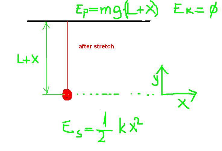

If a man who weighs 1000Newtons(N) makes a bungee jump off a bridge with a 6m bungee rope, this rope has a elastic constant of 2000N/m
A) what is the fastest speed he reaches
B)what is his maximuum kinectic energy
C)how far will bungee rope extend until energy is transformed to elastic potential energy
2. Homework Equations
F=ma, F=kx E=1/2*k*x^2 these are all i know
3. G= 9.81m^2 Gravity*weight/2000 sorry IDK guys please help GCSE Science

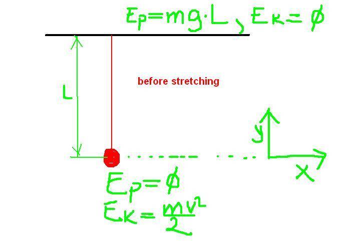

Could you divide this jump in phases? What energy do you have at the bridge, what energy do you have before the "rope" starts stretching?
Check your question values. That bungee rope looks rather stiff. You might have picked up an extra zero.

first 1/2*m*v^2 = mgh
then pug in the values
Hello, John.
Your equation above would work for a situation before rope starts stretching.
You have a 3 key situations: before jump (potential energy is max), before stretching of the rope (kinetic energy is max) and after stretching ("spring" energy).
Please look into photos I attached.
