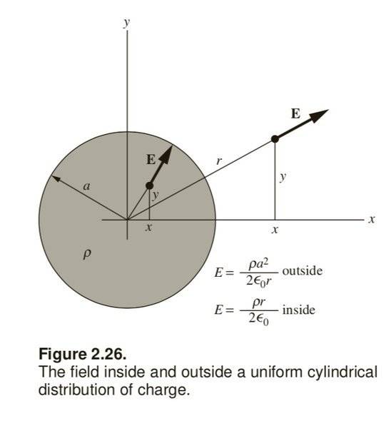

For the cylinder of uniform charge density in Fig. 2.26:
(a) show that the expression there given for the field inside the cylinder follows from Gauss’s law;
(b) find the potential φ as a function of r, both inside and outside the cylinder, taking φ = 0 at r = 0.
2. Homework Equations
I finished part a and got the correct answers. I’m a bit confused about b now. Particularly the bit at the end about taking the potential and radius at 0. Can anybody explain where I start here?

Use Gauss Law to find the electric field in the two regions (or read them off the figure) and then just integrate from the axis of the cylinder out.
Potential is always relative. There is, in principle, no absolute 0. In most electrostatics questions the convention is to set the potential to 0 at infinity, but in this case they are telling you to define the potential as zero at r=0. So the potential at infinity will not be zero.

Use the equation
$$V(r=B)-V(r=A)=-\int_A^B{\vec E \cdot d\vec r}$$
If you choose the potential to be zero at point A while B has some placeholder value r, then
$$V(r)-0=-\int_A^r{\vec E \cdot d\vec r}$$
Usually, the reference point A is taken at infinity. In this case, you are asked to take it at r = 0.
