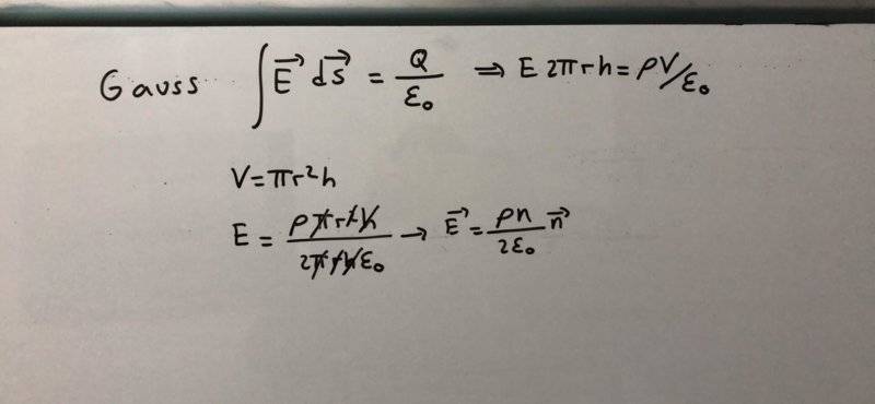

Determine the potential that creates an undefined cylinder of radius $R$ and density density $\rho$ that is uniformly charged.
Gauss's law.
I know that for this problem I can use gauss because it is a cylinder, now I do not get anywhere right, it is also a question of calculating the potential. Some help? Besides, the indefinite thing confuses me a little ...

Yes, of course I'll pass it to you. I think that's fine by now.

It's preferable to type out your equations rather than post pictures. That way, we can easily quote specific parts of your calculations.
In your final expression for ##\vec E##, I take it that the symbol circled in green
should be ##r##. If so, then it looks OK. But is this the electric field at a point inside the cylinder or at a point outside the cylinder?

In your final expression for ##\vec E##, I take it that the symbol circled in green View attachment 222331 should be ##r##. If so, then it looks OK. But is this the electric field at a point inside the cylinder or at a point outside the cylinder?
Yes it is a [ tex ] r [ / tex ] sorry it is not clear. It's the field for the interior I think.
OK, that's correct. Are you trying to get the potential at a point inside the cylinder, outside the cylinder, or both?
What is the connection between electric field and electric potential?

We have seen that ##\vec{E}=\rho \dfrac{r}{2\varepsilon_0}\vec{r}## is in the inside of the cylinder.
Also, ##E2\pi rh=\dfrac{1}{\varepsilon_0}\rho V\Rightarrow E=\dfrac{\rho \pi R^2h}{2\pi rh\varepsilon_0}\Rightarrow \vec{E}=\dfrac{\rho R^2}{2\varepsilon_0r}\vec{r}## is outside the cylinder.
The connection between electric field and electric potential: one is the derivative of the other, is not it? Would I have to integrate in this case? But I do not know anymore.
Please show your work.

I have solved the ##V (r)## for ##r <R## (inner points).
##V(r)=\int_r^0 \vec{E}\cdot d\vec{l}=\int_r^0\dfrac{\rho r}{2\varepsilon_0}\vec{a}_r\cdot d\vec{l}=\dfrac{\rho}{2\varepsilon_0}\int_r^0rdr=\dfrac{\rho}{2\varepsilon_0}\left[ \dfrac{r^2}{2}\right] _r^0=-\dfrac{\rho r^2}{4\varepsilon_0}##

This looks right. Note that you are taking the potential to be zero at ##r = 0##, which is a good choice for this problem.
Have you also been able to get the potential at points outside the cylinder?
