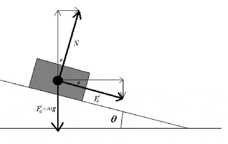

A civil engineer is asked to design a curved
section of roadway that meets the following
conditions:
With ice on the road, when the coefficient of
static friction between the road and rubber is
0.1, a car at rest must not slide into the ditch
and a car traveling less than 80 km/h must
not skid to the outside of the curve.
The acceleration of gravity is 9.81 m/s2 .
At what angle should the road be banked?
What is the minimum radius of curvature of
the curve?
Answer in units of m
I already got the angle which is 5.7105931. What I couldn't get is the radius.
I drew the diagram and I switched the diagram, so that Ff is going to left, Fn is going straight up, and gravity is going south-west at the angle of 5.
I set up the equation as:
Fc = (m*v^2)/r = Ff + mgsin (5.7105931)
Ff = u(s) * Fn
Fn = mgcos (5.7105931)
So m cancels out:
(v^2)/r = u(s) * gcos (5.7105931) + gsin (5.7105931)
BUT I CANNOT GET THE ANSWER. I'VE BEEN WORKING ON THIS FOR HOURS AND IT'S ALREADY 4 AM. IF I DON'T GET THIS ANSWER BY TOMORROW WHEN I WAKE UP I SWEAR I'LL KILL SOMEONE. PLEASE HELP T.T

When you drive round a banked track, the Normal reaction force is greater than when you park in a banked track.
[In a similar way to the reaction force when you drive through a dip, which is stronger than when you park in the dip].
Thus it is not sufficient to merely turn the friction around and retain the size. It will be higher!
Let me know if you need more help [this may have been told by some of the later posts - I only read the first few.]
EDIT: Oh and the Normal Reaction force is of course perpendicular to the road, not vertical. That's why it is called the Normal Reaction Force. Normal as in perpendicular, not Normal as in "the usual thing".

I got 249 m [249.1788 but rounded] using the higher Normal Reaction force.
https://www.physicsforums.com/attachment.php?attachmentid=16984&d=1230443137If this worked you should see a diagram of what you need.
The vertical components of the Normal Reaction Force and the Friction force have to balance the weight force, and the horizontal components of them equal the centripetal force - enagbling you to calculate R - using the speed of 22.222222 m/s of course.
I see no mention of a free body diagram in this thread.
A free body diagram will be a big help. Try it.

I think the word you were trying for is centrifugal, and there is no such thing. And I don't understand your Geometry.
Thank u for the diagram peter. I have that drawn exactly. Wait... Shouldnt it be Fn = Fgy + Ffy?? So Fncos (theta) =mg + Ffsin (theta) no?
Why is it Fn + Ffy = Fg??
Why is it Fn + Ffy = Fg for u??
The bit I highlited in red above is true.
Not sure what you mean by the bit I made blue.
That maths behind this - when using all these components is horrendous.
It leads to the right answer but I was able to do it more simply without resolving the forces at all. Unfortunately I just can't explain it. I might try to prepare a power point. COuld take a day. It is 1:00 am here now. I am off to bed.
I GOT IT I GOT THE ANSWER THANK YOU PETER AND THANK YOU TOO DANIEL ;DDDDD I WOULD KILL YOU BOTH JUST TO SHOW MY JOY AND GRATITUDE, BUT UNFORTUNATELY, I DON'T KNOW WHERE YOU LIVE ;dddd
