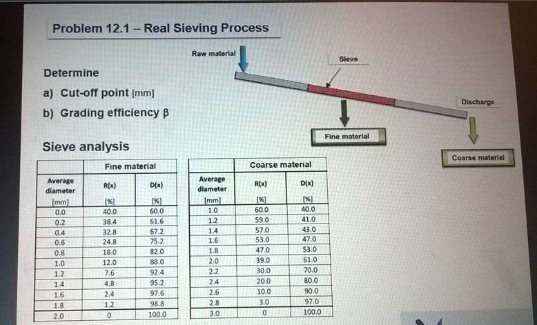

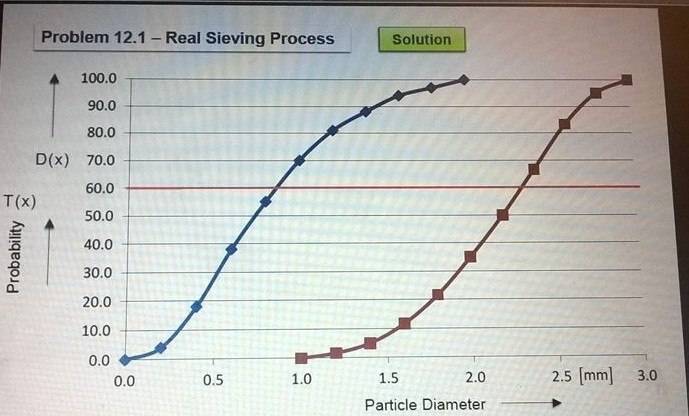

How to draw the graph from the picture. I solved 50% my self like grade Xcut-off point but I do not understand the graph below
