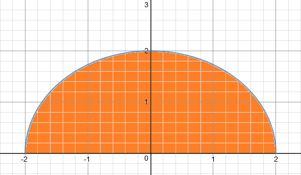

Set up an integral for both orders of integration.
DO NOT EVALUATE THE INTEGRAL.
Let S S = double integrals
Let R = region
S S (x^2 + y^2) dA
R: semicircle bounded by y = {4 - x^2}, y = 0
I can graph the region but have no idea how to proceed from there. I need solution steps.

We should first note that the two boundary functions intersect at $\displaystyle \begin{align*} (2, 0) \end{align*}$ and $\displaystyle \begin{align*} (-2, 0) \end{align*}$, so if we use vertical strips, then they will go from x = -2 to x = 2. Each strip is bounded below by y = 0 and bounded above by $\displaystyle \begin{align*} y = \sqrt{4 - x^2} \end{align*}$, so that means our region of integration is
$\displaystyle \begin{align*} 0 \leq y \leq \sqrt{4 - x^2} \end{align*}$ with $\displaystyle \begin{align*} -2 \leq x \leq 2 \end{align*}$
Let's look at the region over which we are to integrate:
If we use horizontal strips, we see they are bounded on the left by $x=-\sqrt{4-y^2}$ and on the right by $x=\sqrt{4-y^2}$, however, we find the integrand is an even function so we may use the first quadrant area, and double it. We also see the strips run from $y=0$ to $y=2$, and so our integral becomes:
$$I=2\int_0^2\int_0^{\sqrt{4-y^2}} x^2+y^2\,dx\,dy$$
Evaluating, we obtain:
$$I=\frac{2}{3}\int_0^2\left(\left[x^3+3xy^2\right]_0^{\sqrt{4-y^2}}\right)\,dy=\frac{2}{3}\int_0^2 (4-y^2)^{\frac{3}{2}}+3y^2(4-y^2)^{\frac{1}{2}}\,dy=4\pi$$
Now if we use vertical strips, we see they are bounded on the bottom by $y=0$ and on the top by $y=\sqrt{4-x^2}$, and run from $x=-2$ to $x=2$, although we may employ the same even function symmetry we used before, to write the integral as:
$$I=2\int_0^2 \int_0^{\sqrt{4-x^2}} x^2+y^2\,dy\,dx=4\pi$$
We see that in this integral because of the symmetry of the region over quadrants I and II, and the even-symmetry of the integrand, the two dummy variable of integration can simply be interchanged. :D
  • Graph of the upper half of the circle x squared plus y squared equals 4, radius 2, centred at the origin, with the region between the arc and the x-axis shaded orange. Grid lines mark unit squares; axes labelled -2 to 2 and 1 to 3.
