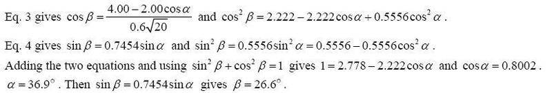

Equation: cos β = (4.00 − 2.00 cos α) / (0.6√20)
how do you square cosB?

I'm trying to understand this part of solution
Typed worked solution: Eq. 3 gives cos β = (4.00 − 2.00 cos α)/(0.6√20) and cos² β = 2.222 − 2.222 cos α + 0.5556 cos² α. Eq. 4 gives sin β = 0.7454 sin α and sin² β = 0.5556 sin² α = 0.5556 − 0.5556 cos² α. Adding and using sin² β + cos² β = 1 gives 1 = 2.778 − 2.222 cos α, cos α = 0.8002, α = 36.9°, then sin β = 0.7454 sin α gives β = 26.6°.
but I don't have any idea on how to square the cosB... It just came out with no detailed solution... please help
if you have f(l) = (x + y) / z where x,y,z are constants
remember you can always change that to
x /z + y/z
and then what would be f^2 (l)
(x /z + y/z)^2 = (x /z + y/z)(x /z + y/z)
and you can expand that right?
