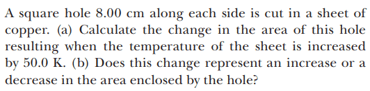

Thermal expansion of square from temperature increase of 50K
The discussion revolves around the thermal expansion of a square due to a temperature increase of 50K. Participants explore the implications of temperature changes on area calculations, particularly focusing on the relationship between linear and area expansion coefficients.

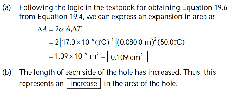

For this problem,
The solution is,
I understand their logic for their equation, but when I was trying to solve this problem, I came up with a different expression:
##\Delta A = \Delta L_x\Delta L_y##
##\Delta L_x =\Delta L_y = \Delta L## since this is a square.
##\Delta A = \Delta L^2##
##\Delta A = \alpha^2L_i^2\Delta T^2##
I also don't understand how how ##\Delta T = 50K## since it should be converted to celsius since the coefficient of linear expansion is in has unit of inverse celsius.
I did that and got ##\Delta T = -223.15 °C## from ##T_k = T_c + 273.15##
Many thanks!
The Kelvin scale and the Celsius scale have different zero points, but they have the same scale factor. Thus a temperature value of 50°C corresponds to a temperature of 323.15 K, but a temperature difference of 50°C corresponds to a temperature difference of 50 K.
A = L2, but ΔA is not (ΔL)2 but Δ(L2)
i.e. A - Ai = Li2(1+αΔT)2 - Li2
=Li2(2αΔT + α2(ΔT)2)
≈Li22αΔT if αΔT is small.

Yes, as @mjc123 points out; take care to write your change in area as follows:
$$(A + \Delta A) - A = ( L+\Delta L )^2 - L^2 $$
##A=L_xL_y.##
The product rule of differentiation is
##dA=L_yd(L_x)+L_xd(L_y)##.
It doesn't change when ##d\rightarrow \Delta.##
Many thanks!
If ##T_K=T_C+273.15,## it follows that
##\Delta(T_K)=\Delta(T_C)+\Delta(273.15~\text{K}##).
How does 273.15 K change as the temperature of the sheet changes?
It doesn't change because it is a constant. So ##\Delta(T_K)=\Delta(T_C).##
