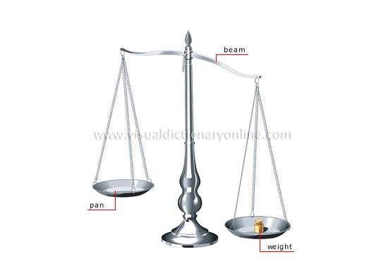

Here's a picture of a beam balance (an old fashioned one):
Two masses that balance on Earth will still balance on the moon.

The scale you illustrated measures the displacement of a spring, which is proportional to the force exerted. The scale is marked in kg for use on earth. Take it to the moon and you'll get the "wrong" reading. If the scale is marked in Newton's, it will work just fine.
Are there other balances that does not depend on forces?
The beam balance that I illustrated will compare two masses. Works just as well on the moon as on earth.
