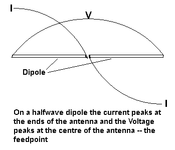

As far as an antenna goes here is where the Voltage and Current are peaking...
Dave

What does "peaks" mean here, thanks for helping answer more about dipoles and congratulations on making it to 1000 posts! I realize now that some of my posts on this thread don't have much to do with dipoles, sorry, how do I fix that? I don't want to be rude and seem selfish.

That picture is a single snapshot... the peaking of voltage and current alternates between:
high V low I at the ends with low V and high I at the center,
and
low V high I at the ends with high V and low I at the center.

OK, the diagram is showing you where on the halfwave dipole antenna that the current and the Voltage peak. You can see that over a half wave of a cycle of the applied AC signal that the current (I) peaks at each end of the dipole and is at zero in the middle - at the feedpoint. Whereas the Voltage is opposite, it is at zero at the ends of the antenna and it peaks at the centre where the feedpoint is.
cheers
Dave
