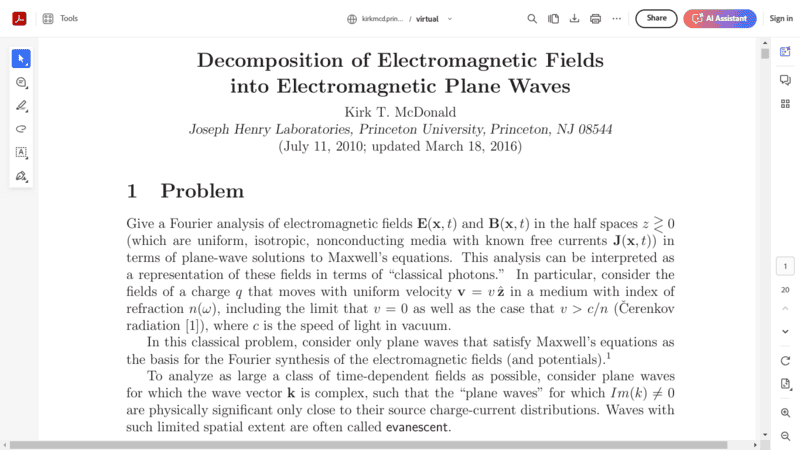

A dipole antenna will have near fields and far fields. Can both the near and far fields can be decomposed into an infinite sum of plane waves?
If so, are the plane waves for far fields and near fields of different type or class? Near fields must die off at infinity but far fields do not.
Thanks.

I am sure you would understand the paper I linked. I think my question is answered? The fields of a Hertzian antenna can be decomposed into an infinite sum of plane wave that give both the near and far fields? Is it hard, looks like it. Why Professor Kirk T. McDonald would solve this problem I guess only he knows. I am glad he did though.
Thanks.
Thanks.
I'm not convinced. First, the author states on p. 8
"To this author, there is very limited physical reality to the inhomogeneous plane
waves [describing the near field] identified in the expansions (41)-(43)."
I read that part. He comes up with an expansion for the Hertzian dipole in terms of plane waves that are equivalent to the fields of the original problem. That was my question, seems answered. Does the plane wave superposition that represents the near fields have some physical reality, he does not think so and I am ok with that. He did not state as fact just his opinion, he makes an interesting observation. One could ask what is the reality of a plane wave in physics. You might just say its an abstraction used in physics that works?
I did say dipole antenna in my question, I could have been more clear. That it can be done for the Hertzian antenna is cool, might his technique work for a more realistic antenna I don't know.
Thanks.
Agreed, if you are after a Hertzian dipole then the case is settled.
