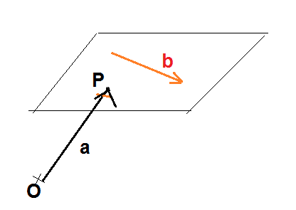

No, it is a point , common point of the first plane an the line I. P (1,4,-1) is the position vector a of this point, it does not lie in the plane as vector b. But the line I lies in the second plane and so is its direction vector. What is it?
3D diagram of a plane drawn as a parallelogram, with point O below it, point P on the plane, vector a drawn from O to P, and vector b shown as an orange arrow lying within the plane.
