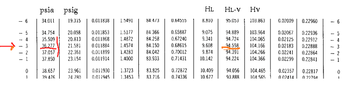

jim hardy said:
at that point we have zero subcooling. So if there's any liquid in the condenser it's not much.We are just beginning to involve phase change.
Look at the HLiquid column - it's down to 36.158 BTU/lb
Suction pressure should be ##\frac {discharge ~pressure} {compression~ ratio}## = 183/5 = 36.6psia
which is the pressure in the evaporator
so go back to the saturation table for that pressure
that liquid is going to evaporate at about -3°F, and absorb 94 BTU/lb as it does
but there's not much liquid so it evaporates quickly and gets ever more superheated as it continues toward compressor suction
As we add more refrigerant we can make more than just a tiny droplet of liquid in the condenser
so the liquid level in there will rise
and the greater amount of liquid that's entering the evaporator will fully evaporate further up the evaporator before beginning its superheat
I think I got the gist of what you were saying until you got to the chart you included right above the sentence "As we add more refrigerant we can make more than just a tiny droplet of liquid in the condenser." Here is my interpretation of what you're saying here: "The liquid refrigerant absorbs 94 BTU/lb as the liquid refrigerant evaporates. 94 BTU/lb is a lot more than the 9.608 BTU/lb the liquid refrigerant absorbs before phase change. Therefore, phase change is dollars and subcooling and superheating is pennies."
But what about the fact that your chart says that the vapor enthalpy is 104 BTU/lb? 104 BTU/lb>94 BTU/lb ---Based on this fact, couldn't someone say that superheating is more dollars than phase change?
I don't have much of a scientific background. My only scientific background that is relevant to this subject is Chemistry class in my junior year of high school, and physics class is my senior year of high school. I graduated from high school in the year 2000, so I am even rusty as far as the limited amount of what I learned in these classes in high school.
When I see your chart saying BTU/lb of Enthalpy for liquid, latent, and vapor, I know that it is about heat somehow, but I don't know exactly what it means.
As I recollect, entropy somehow expresses the "chaos/orderliness" of the heat of a system, and that is 100% of what I know about entropy. In other words, I know extremely little about what entropy means.
Please help me understand this.

#2 can't be right, because the thermodynamic properties of the refrigerant at a fixed location inside the system, in a steady state, should not change from one parcel to the next. So each parcel passing the exit of the condenser, for example, should have the same subcooling if everything is in a steady state. Otherwise it wouldn't be a steady state.

I have a table in my textbook that gives the pressure of R-22 at different temperatures. I didn't know that the pressures of R-22 at each different temperature are the saturation pressures of R-22.

PeterDonis said:
If all the table is specifying is pressure, the only thing that makes sense is that it's telling you saturation temperature. See above.
Good point. You're probably right.
I would have to see the textbook to be able to figure out what it's telling you.
Here is a photograph of the table I am referencing from my textbook:
pressure chart
  • #45
By itself that doesn't show enough context for me to see what it's a table of. But the 90 F entry in the 22 column says 168.4, which matches the table that @jim hardy posted in his entry, so this looks like a table of saturation pressures vs. temperature.
Here is the entire text with the table: "Figure 3.15 This chart shows the temperature/pressure relationship in in. Hg vacuum, or psig. Pressures for R-404A and R-410A are average liquid and vapor pressures."

PeterDonis said:
That's not what I said. The small effects on saturation temperature with pressure has nothing whatever to do with how much of the condenser is occupied by subcooled liquid. I was simply pointing out that, as you change the charge, the pressure changes, therefore the saturation temperature of the refrigerant changes.
Good. I was hoping that you would say that the small effects on saturation temperature with pressure has nothing whatever to do with how much of the condenser is occupied by subcooled liquid. I like it when everything makes sense to me.
In your post #36, you were just telling me that there is another reason that there are two reasons that increasing the charge increases subcooling: 1# increasing the charge increases the percentage of the condenser being occupied by subcooling liquid and 2# increasing the charge increases the saturation temperature of the refrigerant.
I finally feel like I understand this 100%. Well done. You would have been a good physics/engineering professor.
