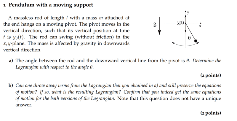

Can one throw away terms from the Lagrangian that you obtained in a) and still preserve the equations of motion?
Result from task 1
##L=\frac{1}{2}m(\dot{\theta}^2l^2-2\dot{\theta}lsin\theta A\omega sin(\omega t)+A^2\omega^2sin^2(\omega t))+mg(\dot{\theta}lsin\theta-A\omega sin(\omega t))##
In problem 1 I assumed that the suspension moves up and down in an oscillating manner, so ##y_0(t)=Acos(\omega t)##
I am not quite sure about task 2, but I would say you can remove the motion of the suspension and the motion of the system would not change noticeably, as I assume that the suspension is moving at constant speed and therefore no external force is acting on the system and thus not affecting its motion. So whether the suspension moves or not does not change the typical motion of the pendulum.

Sorry, I had unfortunately uploaded the wrong screenshot, here is the correct screenshot with the complete task

Lambda96 said:
... I assumed that the suspension moves up and down in an oscillating manner, so ##y_0(t)=Acos(\omega t)##
Is that a reasonable assumption?

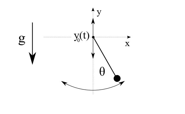

On the diagram, there are up/down arrows at the pendulum's pivot. But I don't see how you can use that as justification for assuming anything about the specific form of ##y_0(t)##. Or is there some contextual information missing?
You're right, there's nothing about it in the assignment, so unfortunately I can't use a statement like that.
But the suspension itself does not depend on the angle ##\theta##, so I could take the term with the suspension out of the equation without changing the equation of motion.
That's not what it's asking.
Take your general Lagrangian, it should have ##y## and ##\dot{y}## terms.
Pick your 2 coordinates you're solving for EOM (there are 2 degrees of freedom, hence 2 EOM).
Calculate the partial derivatives, and note any terms that go to zero when you take the derivatives. Are there any terms that go to zero in both EOM calculations. I suppose maybe some terms could just cancel out as well, if circumstances permit it.

##y_0(t)## is some predefined (supplied) function.
Once ##\theta## is known, the y-coordinate of the pendulum's mass can be geometrically determined from ##\theta, ~y_0(t)## and ##L##.
So surely there is only one degree of freedom (and one EoM).

It's a potentially confusing use of symbols by whoever wrote the original question.
##y_0## would typically be used as the symbol for the initial value of ##y## (i.e. ##y_0## would be a constant), not some variable.
Here, I suspect the 'nought' may be intended to be the letter 'O', to denote the origin of a (moving) coordinate system where the pendulum's pivot is at the origin. ##y_p## might have been a better choice!

@Lambda96. I’m guessing what you have to do might be this:
For part a), express the Lagrangian in terms of ##y_0, ~\theta##, their derivatives, and constants.
To make sense of part b) you could state that you will consider the special case where ##\ddot {y_0}=0##, i.e. the pivot is not accelerating. Some terms in the Lagrangian should vanish. (The EoM - which is not actually required - would then be the same as for a standard simple pendulum.)
