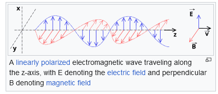

BTW, remember that light and other Electromagenetic (EM) radiation consists of oscillating electric field and magnetic field waves. They propagate through a vacuum just fine. :wink:
https://en.wikipedia.org/wiki/Light
