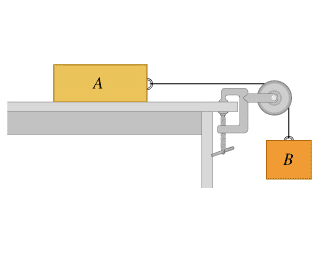

Consider the system shown in the figure (Figure 1) . Block A weighs 46.1 N and block B weighs 28.7 N . Once block B is set into downward motion, it descends at a constant speed.
http://session.masteringphysics.com/problemAsset/1038576/6/YF-05-54.jpg
A
Calculate the coefficient of kinetic friction between block A and the tabletop
μ= 0.623
B
A cat, also of weight 46.1 N , falls asleep on top of block A. If block B is now set into downward motion, what is its acceleration magnitude
F=ma
∑F in x direction of A: -F+T = ma
-μ92.1+T = 92.2/ 9.8 a
-.623(92.1)+T=9.4 a
∑F in y of A N-w = ma
92.2-9.4(9.8) = 0
∑F in Y of B T-w
T-2.93 (9.8) = 2.93 a
T= 28.7+2.93a
plug T into first equation: -.623(92.1)+28.7+2.93a = 9.4a
-.623(92.1)+28.7= (9.4-2.93) a
divide both sides
( -.623(92.1)+28.7) /9.4-2.93 = a
gives me wrong answer, where did I go wrong?

So i have looked through your original post and i have found some problems. Like -μ"92.1"+T = 92.2/ 9.8 a => "92,2"
But i suggest you using this formula : a = ΣF / ΣM, more faster and i think that you should start again rather than try figuring the mistake

I think that the friction force is greater than gravity so the system won't move

it is zero in part a but non zero in part b. The error is in part b.

PhanthomJay said:
What is the direction of the acceleration of each block?
A is left
B is up
David112234 said:
A is left
B is up
which force is moving the body A towards the left?

What is wrong with what I posted?
The friction force u92.2 is pulling left and Tension pulling right

Friction
Got it, I was missing a negative sign, thanks

friction can not move -it can only provide resistance to motion-
if your body is pulled left it will oppose it
again if your body gets pulled towards right it will oppose it - so will there be motion towards right if it opposes the motion?
Yes the motion is to the right but the acceleration is to the left so the object is slowing down due to the friction force which acts towards the left. I figured out the answer, my mistake was not putting a negative sign in front of the acceleration
