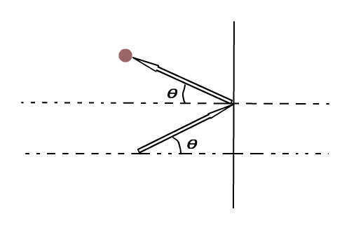

I don't think it's unsolvable as stated. Wouldn't it look something like this?
Diagram of a ball striking a vertical wall, with an incoming path from the upper left and a reflected path to the lower left, both making angle θ with horizontal dashed lines meeting at the wall.
I don't think I see how the depiction could be misconstrued.
It's not that the diagram can be misconstrued, it's that it's incomplete. It doesn't show the magnitude of the velocity vector. That magnitude will vary with the angle of the plane in which the diagram is drawn to the plane of the wall - the azimuth angle. If that angle is very small then the velocity will be small. The velocity will be maximised when the angle is a right angle.
Think about the following two situations in a squash court:
1. you are in the front RH corner and hit the ball almost parallel to the wall, at an angle 28 degrees to the horizontal, so that it just grazes the front wall
2. you are at the rear of the court and hit the ball in a direction whose horizontal component is directly towards (at right angles to) the wall, and at 28 degrees to the horizontal
These are both at 28 deg to the horizontal. But the second will hit the wall much harder than the first.
