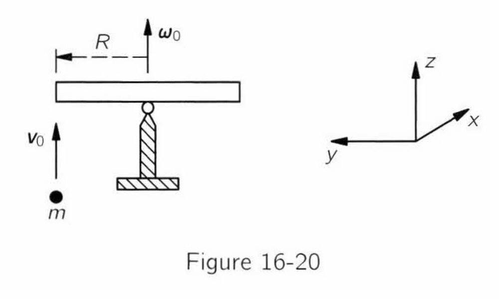

A uniform thin disc of radius ##R##, mass ##M## is mounted on a universal bearing permitting rotation about any axis. Initially it spins about a vertical axis (z-direction) with angular velocity ##\omega_0##, as shown in Fig 16-20. A small mass ##m## with velocity ##v_o## in the positive z-direction collides elastically with the rim of the wheel and rebounds in the negative z-direction.
a) What is the direction of the angular momentum ##\vec L## of the disc after the collision?
b) Describe the motion of the figure axis. Indicate by sketch the trajectory of the point of intersection of the figure axis with a unit sphere as seen from the top.

Consider the system of the mass and uniform disc.
Since no external forces act on the system, the angular momentum will be conserved. For elastic collision, the kinetic energy of the system stays constant.Measuring angular momentum from the hinge:
##\vec L_i = Rmv_0 \space\hat i + I \omega_0 \space\hat k##
##\vec L_f = -Rmv_f \space\hat i + \vec L##
where ##I=\frac12MR^2## and ##\hat i, \hat j, \hat k## are unit vectors in ##x,y,z## direction respectively.
By conservation of energy:
##\frac12mv_0^2+\frac12I\omega_0^2 = \frac12 mv_f^2 +\frac12 I\omega_f^2 \implies m(v_0^2−v_f^2)=I(\omega_f^2−\omega_0^2)##
The angular impulse acting on a disc during the mass collision produces the torque perpendicular to the angular momentum. Therefore only the direction of disc's angular momentum changes, while magnitude stays the same.
Thus:
##I\omega_0 = I\omega_f \implies \omega_0^2 = \omega_f^2##
From conservation equation we then conclude, that ##v_0=v_f## and since the problem states that the mass bounces in exactly the opposite direction, ##\vec v_f = -\vec v_0##
By conservation of angular momentum:
##Rmv_0\space\hat i+ I\omega_0 \space\hat k= −Rmv_0\space \hat i+ \vec L\implies \vec L = 2Rmv_0\space\hat i + \frac12MR^2\omega_0 \space\hat k##
The answer in the textbook is given as:
##\frac{L_x}{L_z} = 4mv_0/MR\omega_0## which agrees with above.
The problem arises when one inspects the angular impulse argument (which, considering the fact that the (internal) force from the collision, acting on a disk is normal to the surface, so angular momentum magnitude shouldn't change at all times, even if the mass does not rebound in the same direction, is really compelling).
However clearly ##\lvert\vec L_0\lvert \not = \lvert\vec L\rvert##
Where is the flaw?
I think the flaw is assuming that the impulsive torque is perpendicular to the angular momentum of the disk during the collision. The impulsive torque is perpendicular to the initial angular momentum of the disk, but not perpendicular to the final angular momentum of the disk (immediately after the impulse). The transition from the initial angular momentum to the final angular momentum takes place while the torque is acting. So, I don't think it is correct to say that the torque acts perpendicular to the instantaneous angular momentum while the angular momentum is changing from the initial to the final value.
It can be confusing when we think of the angular impulse as acting at only one instant of time, rather than acting over a very short interval of time.
It might help to consider the case where the initial angular speed of the disk is extremely small so that the initial angular momentum is extremely small. (Imagine ##\omega_0## to be so small that we can't notice any rotation even after a few minutes.) In this case, we would certainly expect the collision to alter the magnitude of the angular momentum of the disk.

Let ##v_0## and ##v## be the initial and final speeds of the particle (both positive numbers). The force that acts on the disk during the collision is normal to the disk. So, the torque on the disk is parallel to the disk. Orient the x-axis to coincide with the direction of the torque. Let ##L_x## be the angular momentum picked up by the disk due to the collision.
Conservation of angular momentum of the system: $$m(v+v_0)R = L_x$$
Conservation of energy: $$\frac 1 2 m(v_0^2-v^2) = \frac{L_x^2}{2I_x}$$
Solve these for ##v##: $$v =v_0 \frac{1-4m/M}{1+4m/M} \approx v_0(1-8m/M)$$If ##m## is small enough compared to ##M## that ##8m/M## can be neglected compared to 1, then ##v \approx v_0##. In the following we will retain terms of first order in ##m/M##.
$$L_x = m(v+v_0)R \approx 2mRv_0(1-4m/M)$$
$$\frac{L_x}{L_z} \approx \frac{4mv_0}{MR\omega_0}(1-4m/M)$$
$$\omega_x = \frac{L_x}{I_x} \approx \frac {8mv_0}{MR}(1-4m/M)$$
$$\Delta K_{\rm disk} = \frac 1 2 I_x \omega_x^2 = \frac{L_x^2}{2I_x} \approx \frac{8m^2v_0^2}{M}(1-8m/M)$$
The change in the magnitude of the angular momentum of the disk is $$\Delta L_{\rm disk} = \sqrt{L_z^2+L_x^2} - L_z \approx \frac{L_x^2}{2L_z} \approx \frac{4m^2v_0^2}{M\omega_0}(1-8m/M)$$
From the last two equations, we see there will be a change in the kinetic energy and the magnitude of angular momentum of the disk (even to "zeroth order" where ##8m/M## is neglected compared to 1).

Thank you for an elaborate answer. The result agrees completely if one assumes ##m << M##.
I have suspected that the final speed of the particle must be different but the textbook answer put me off the track.
I guess it is a lesson to check it only after fully understanding the problem.
