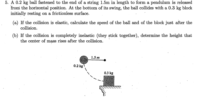

If a ball weighing 0.2 kg is fastened at the end of a 1.5m string and is released from the horizontal position, what will the velocity be when the pendulum is at the bottom of the circle.
So I was wondering if I could use energy conservation for this question because that would make it a lot easier, if not how exactly would I start because this is not uniform circular motion.

Here is the question
Physics problem diagram: a 0.2 kg ball on a 1.5 m string held horizontal, swinging down to hit a 0.3 kg block on a frictionless surface, with the problem text above.
How can you get the height that the centre of mass rises if you don't apply the same logic from b) to a)?

OK, you previously left out the 'sticking together' bit.
Clearly you can use energy conservation in a).
For b), you must consider two events:
- the collision itself, which is inelastic, so energy is not conserved. Instead, you know that the two objects move together afterwards, so you have an equation from that instead of the work equation. Find the velocity then.
- after the collision, work is conserved during subsequent motion.
oh wait so the b) part is saying, when they stick together and they continue on that path at the new velocity what is the maximum height it reaches?
Also for the a) part I would like to check the logic of my answer. So first of all I got the initial v of the ball just before it hits the block with energy, then I made m1v1 = m1v1' + m2v2', but I had two unknowns so since it is an elastic collision I can use energy so then I did (0.5)m1v1^2 = (0.5)m1v1'^2 + (0.5)m2v2'^2, then when everything was subbed in I had to use the quadratic formula, and got -0.198 and 9.01 m/s, I think that -0.198 is the most applicable intuitively, right? Also I still don't understand b) is it looking for the change in height of centre of mass when they are stuck together versus when they are apart or what?

You can avoid quadratics. (1) m1v1 = m1v1' + m2v2'; (2) m1v1^2 = m1v1'^2 + m2v2'^2
From (2): m1(v1^2 - v1'^2) = m2v2'^2 = m1(v1-v1')(v1+v1')
From (1): m1(v1 - v1') = m2v2'; m1(v1 - v1')(v1+v1') = m2v2'(v1+v1')
Combining: m2v2'^2 = m2v2'(v1+v1'); v2' = v1+v1'
This is just Newton's Experimental Law with coefficient of restitution = 1.
You know they have the same speed after impact in this case. Find that speed. What KE does that imply? If they continue together (still attached to the string), what will be their KE at the highest point of the swing?
Yea now I understand b) its 1/2m(1+2)vf^2 = m(1+2)gh
so then in that rearranged energy equation do we just get the momentum equation, and sub it in? It seems to me just by the equations you showed me that you can't isolate for one variable, I am probably wrong though. So after that I derived the equation for v1' = (m1v1 - m2v1) / (m1+m2), is that right?

Why the -m2v1? Pls post your derivation of that equation.
m1(v1-v1')(v1+v1') = m2v2'^2
v2' = v1 + v1'
m1(v1-v1')(v1+v1') = m2(v1+v1')(v1+v1')
m1v1 - m1v1' = m2v1 + m2v1'
m1v1 - m2v1 = m2v1' + m1v1'
v1(m1-m2) = v1'(m2+m1)
v1' = v1(m1-m2)/(m2+m1)

Oh, sorry, I thought your post #17 was on part b.
Yes, this is right for part a.
