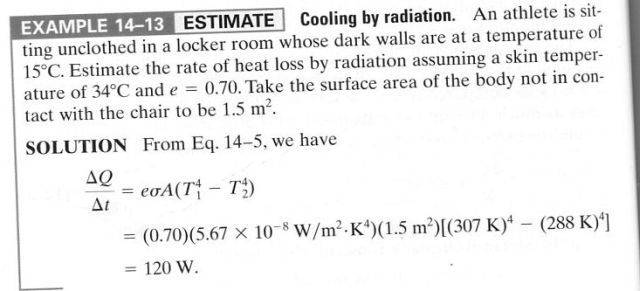

4. average adult skin surface area = 1.8 m^2. ****If I did my math correctly...could I please have some opinions on what would create the difference in my answers in part 3 and 4? Thanks PF! I though perhaps it relates to the fact that different parts of the body radiate at different rates?
For one thing, remember that when a body radiates energy, it also accepts energy from its environment.
Also, the body may experience cooling from evaporation of water on the skin.
Attached is an example from a physics book
  • Textbook page, Example 14-13 Estimate: cooling by radiation, showing the solution of heat loss by radiation from a 1.5 m^2 skin surface at 34 C in a 15 C room, with the calculation resulting in 120 W.
