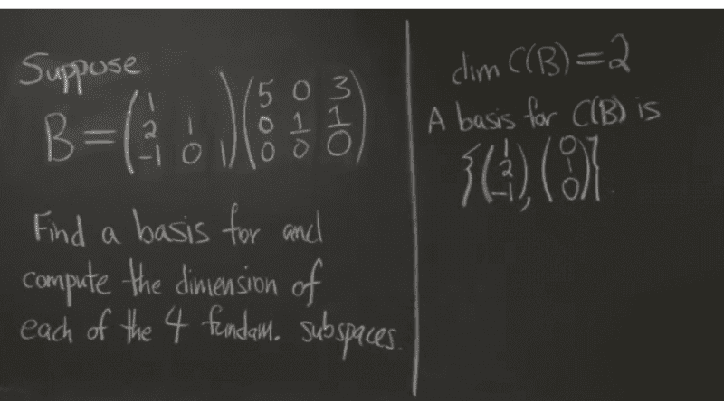

I see that the pivots in columns 1 and 2 help us decide which columns to take. But why does the L matrix of this B = LU let just to read off the column space?
Chalkboard lecture slide: Suppose B is a 3 by 2 matrix times a 2 by 4 matrix shown as a product, asking to find a basis for and dimension of each of the 4 fundamental subspaces. Right side reads dim C(B) = 2 and a basis for C(B) is the set containing (1, 2, -1) and (0, 0, 1).
2:18
The column space of ##B## is the set of all ##Bx##, where each ##x## is a ##3 \times 1## vector whose elements are the coefficients of a particular linear combination of the columns of ##B##.
If ##B = LU##, then ##Bx = LUx = L(Ux) = Ly##, so any linear combination of the columns of ##B## is also a linear combination of the columns of ##L##. This means that ##C(B)## (the column space of ##B##) is a subspace of ##C(L)## (the column space of ##L##).
In this case, ##C(B)## is a proper subspace of ##C(L)##, which we can see by arguing as follows. By inspection, the columns of ##L## are linearly independent, so ##L## is invertible. This means that the null space of ##B## is the same as the null space of ##U##, because invertibility of ##L## implies that ##LUx = 0## if and only if ##Ux = 0##. Since ##U## has two linearly independent columns, ##U## has rank 2, so the dimension of ##N(U) = N(B)## is 1. Therefore ##C(B)## has dimension 2, whereas ##C(L)## has dimension 3.
Moreover, by examining ##U## we can see that ##C(U)## consists exactly of vectors of the form ##(a,b,0)^T##, since the third row of ##U## is zero. This means that only the first two columns of ##L##, namely ##(1,2,-1)^T## and ##(0,1,0)^T## contribute to the column space of ##B##. Since these two columns are linearly independent and ##C(B)## has dimension 2, they form a basis for ##C(B)##.
