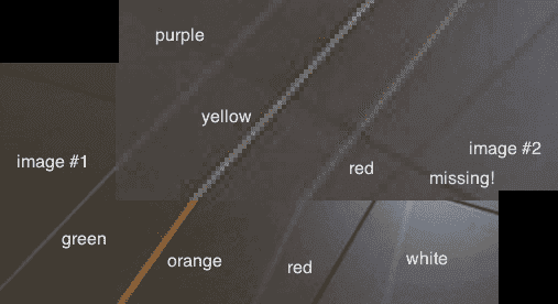

Jonathan Scott said:
As far as I can tell, those lines are indistinguishable from parallel, so the source was not close. This suggests that sunlight was being temporarily redirected and refracted through some distant object, perhaps across the road, producing a continuous spectrum, which was split into lines by the blind. Of course, looking through the blind from low down would have revealed the source.
I don't think the rays are from refraction. One thing I missed up until now, is that the OP said:
YeeHaa said:
When I rotate the shutters as you can see from the pictures, the colors changed.
Which is indeed true:
Two overlapping photos of diagonal light streaks with labels: image #1 at left with green streak, image #2 at right showing purple, yellow, red, orange, red, white streaks and the note 'missing!'.
I was working with image #2, and completely ignored image #1.
The spacing of the colors, along with the anomalous white ray(s, and pinkish one that I didn't include), indicates to me that the rays are not the product of refraction, nor diffraction, but could only be the result of light reflecting off of a multicolored surface.
ps. I suspect the entire problem is photo-shopped*, but given that this is a delightful test of math skills, I really don't mind.
*The orange line is a bit too "crisp", IMHO.
  • Two overlapping photos of diagonal light streaks with labels: image #1 at left with green streak, image #2 at right showing purple, yellow, red, orange, red, white streaks and the note 'missing!'.

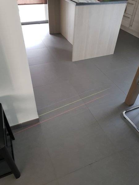

Hello all,
Wow! thank you for the huge amount of replies.
In a lot of replies I read some doubt about my sincerity but believe me (on my pretty blue eyes): no photoshop, no cheating. The pictures were taken with my Galaxy S8 phone and were uploaded straight to this forum (shared via mail).
I will make some more overview pictures when I get the chance.
There were also comments as to why I blanked out the table. Simply because it was not relevant and I considered that as my own private (mess) ;-).
I had some discussion at work (I am an opto-mechanical engineer) and were also on the path of "the blinds are shading part of the coloured spectrum"... But no solutions (yet).
Just for the fun of it, I uploaded the third picture I took that day so you can see I am not cheating ;-)
  • Photo of a grey tiled floor in a kitchen with a faint red and green line pattern of light crossing the tiles diagonally, with a white kitchen island and a black chair edge visible.
Using the most recent photo that @YeeHaa posted:
Using the much lower distortion of that photo, I get the parallelism of the color rays as within 2.3°, well within the measurement error of being parallel. Even if the 2.3° is accurate, that puts the source distance at 25 tiles away (50ft. or 15m.).
Question for YeeHaa: Is that effect reproducible enough that you can visually sight along one of those rays to determine the source?
I hope so. You have a whole bunch of us VERY curious as to the cause.

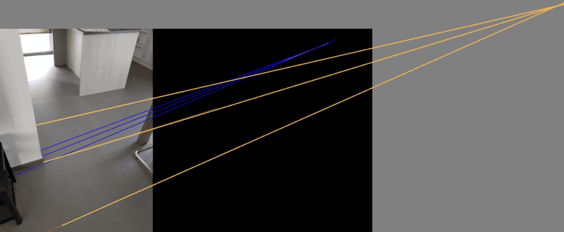

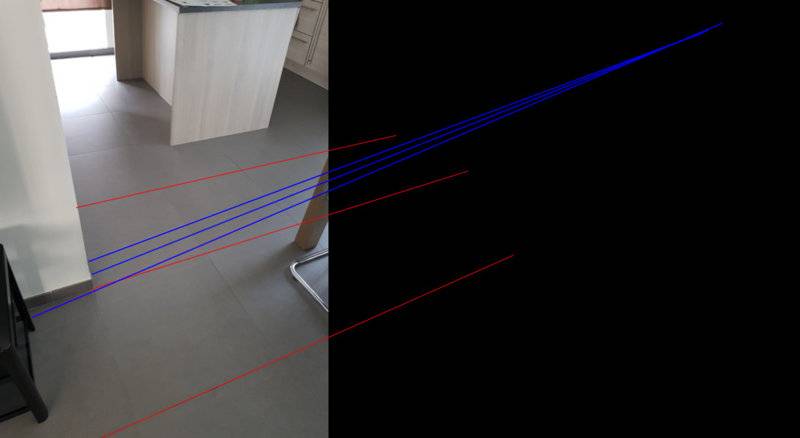

No way.
They definitely converge closer than the horizon.
Look a the truly parallel rays of the tiles. They converge at infinity.
The light rays definitely converge within metres of the window.
Photo of a tiled kitchen floor with a wooden island and a chair, overlaid on the right half with black background showing red and blue lines converging to the upper right.
  • Photo of a tiled kitchen floor with a wooden island and a chair, overlaid on the right half with black background showing red and blue lines converging to the upper right.
The Yellow shows the vanishing point of the Red lines relatiing to the floor tiles.
Photo of a room with a tiled floor and white cabinets, overlaid with orange and blue lines converging to a vanishing point at the top right, on a black panel.
  • Photo of a room with a tiled floor and white cabinets, overlaid with orange and blue lines converging to a vanishing point at the top right, on a black panel.
Yes. That'll be the horizon, same as Omcheeto showed in post 16.
The light rays do not converge at the horizon, but much closer.
